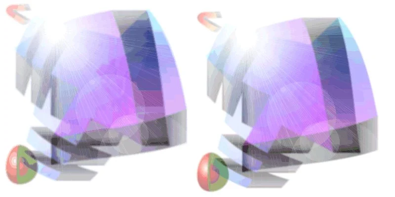

Now here are the two different versions – 8 bit processed and 24 bit processed. Can you tell which is which?

24 bit is the 2nd one.
you can see (top left and bottom left) where the colors overlap...a LOT smoother look..
