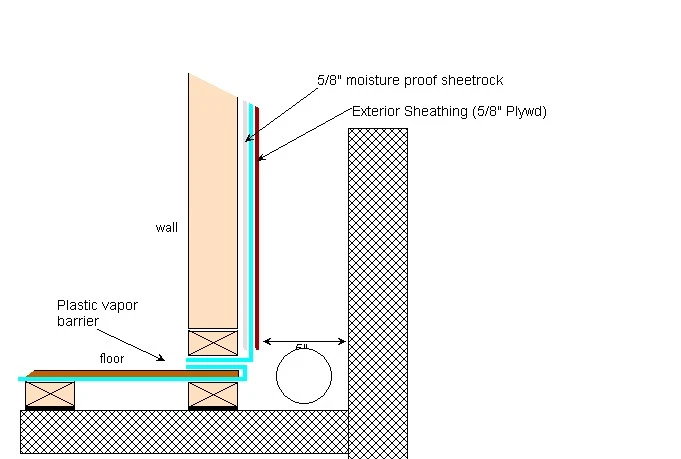

Thanks for all your suggestions. Like I said, fortunatly, I don't have big water problems in the basement and knowing it cannot be stopped completely (nature of the beast :) I want to try and control it. Attached is the plan... I'll be doing the floor portion this weekend. I'm thinking of placing a drainage pipe (with holes) on the floor between the inner and outer walls. I can then connect a fan to one end and force air around when the humidity gets high.
Thoughts?
Cheers
Kevin.

Longsoughtfor,
If its a very small (4sq') on one wall, the source should be easy to find and fix. Maybe you have a gutter downspout that needs re-routing, or one area of the outside wall that didn't get treated properly, or as Bozman stated: a grade problem. Maybe even a small leak in your water supply line or sewage line or an opening in the foundation where they enter the house. A leaking or mis-routed air conditioner condensate drain might be the culprit since it only happens in the summer. I had a shower control that didn't get caulked and a very tiny amout of water would run down the basement wall below it, but only when the shower was on and water was being splashed in that direction.
