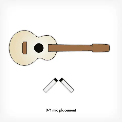

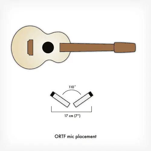

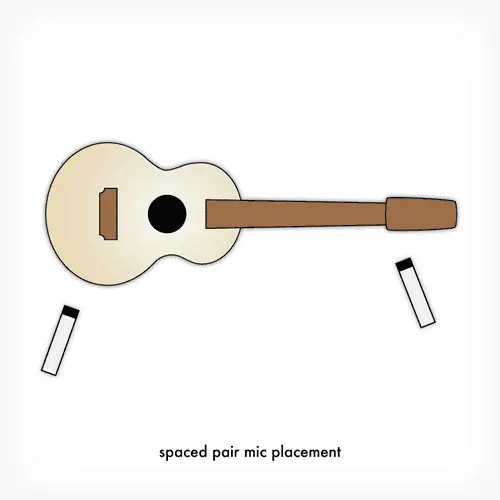

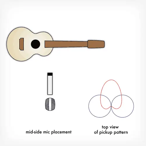

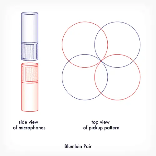

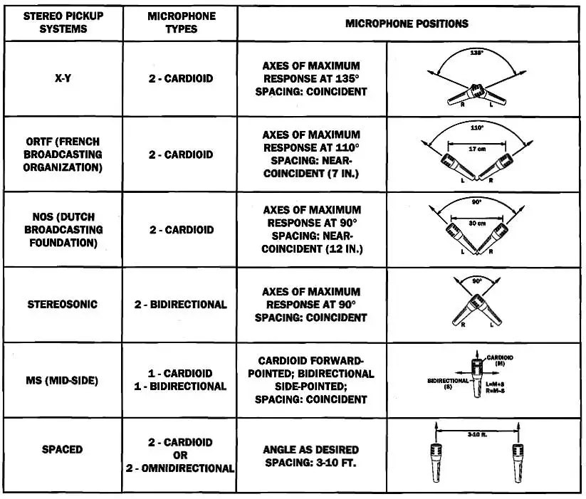

I have two mics, an AKG 414 and a Neumann KM 183 that I run through two different channel strips, then into my DAW. What logic do you recommend for how to set EQ and compression, etc on these strips for each mic, and what pattern would you select on the mics?
I am brand new to recording. If there is any other advice you could provide I would really appreciate it. PlugIns, techniques etc. I am recording acoustic solo fingerstyle guitar principally.

		![ShureStereoMikingTechniquesChart[1].webp ShureStereoMikingTechniquesChart[1].webp](https://img.homerecording.com/attachments/52/52570-2e01236c9a8ff7100cde8877fd2c2521.jpg?hash=cMcRVbvGgn)
![spacedpair[1].webp spacedpair[1].webp](https://img.homerecording.com/attachments/52/52571-8c5555f899b19ba80c8ed337c6bb8699.jpg?hash=F5zPW3_NIs)
![x-y[1].webp x-y[1].webp](https://img.homerecording.com/attachments/52/52572-d3884d8f72cb94fade007e337a19daf2.jpg?hash=UdKRhr6d0m)
![ortf[1].webp ortf[1].webp](https://img.homerecording.com/attachments/52/52573-4bb7d6f142f3fd51afa122abb98bd154.jpg?hash=w7Wm2r_cVB)
![midside[1].webp midside[1].webp](https://img.homerecording.com/attachments/52/52574-bae64f9d05509518703ca63699f8f915.jpg?hash=UbOKPgKW6t)
![blumleinpair[1].webp blumleinpair[1].webp](https://img.homerecording.com/attachments/52/52576-c9f25cece0e48cab3554c1ed69063aeb.jpg?hash=g2TCkGTdrd)
