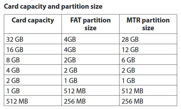

Which Tascam recorder are you using? Some have a somewhat unorthodox storage scheme. They have the standard FAT portion that is readable on a computer, and a special MTR formatted partition that is not readable by computer. Because of this, you cannot simply copy the data from one card to another.
The DP03SD and DP008 have this type of setup. If your recorder says that you must export your tracks to move them to a computer, then you probably have the FAT/MTR format. Check your user manual regarding formatting an SD card. You might have a chart that lists something like this:
If you indeed have this format, you will need to export to a computer and then import it to a new card. With the price of SD cards, buy a 5 pack of 16 or 32GB cards and you probably wont have to worry anymore. I use my SD cards once now and put them away for storage. $5-7 for 4 to 6 hours of 8 track recording is CHEAP!!!!

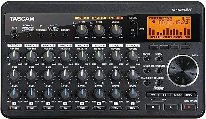

Thanks very much for the help, I was afraid it might be some issue like that. I have the "TASCAM Compact 8-Track Digital Pocketstudio Multitrack Recorder (DP-008EX)". I have had it for years, though it is also on Amazon. I have no idea what kind of file storage it follows. It appears to be one you have mentioned with the second type of file setup.

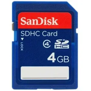

Seeker, the write protect tab is on all SD type cards. It's little tab that says "LOCK". The micro SD cards don't have it, but if you have it in an adapter, it can lock the card.

As for moving the files, you need to go through the export process. This moves files from the MTR to the FAT partition. There is NO WAY to read the MTR partition, as it's not compatible with any standard computer file system (PC or Mac). Just do a Google Search for "read TASCAM MTR format " and you'll see a half dozen requests for the same info without any resolution. It's a proprietary data format. For me that would be one of the weak points for the Tascam DP series.

If the MTR partition is full, you'll never see it putting it in a computer. It takes up 50% of space on the card.
