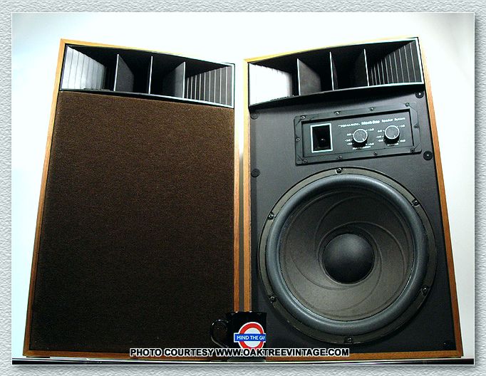

I agree with all of the above and my very first "studio monitors" were a pair of used Radio Shack "Mach-I" speakers, model 4024 "A". They had an adjustable crossover whereas I could tweak them to "somewhat" flat and compensate the rest with my brain.
The only thing I didn't like about them was how inefficient they were - to get a reasonably flat sound I had to apply lots of power - at least 75W RMS. Below that, the bass response rolled off very quickly and at about 40W, all you'd hear is mid and high frequencies with an occasional "thump". That might have been the amp I used though - it was a massive vacuum tube amplifier rated for 95W RMS, also made in the late 70's.
wow ..... I haven't seen any of those for quite a while but I remember them.
Never had a pair but I had a couple of other Radio Shack speakers that weren't too bad.
