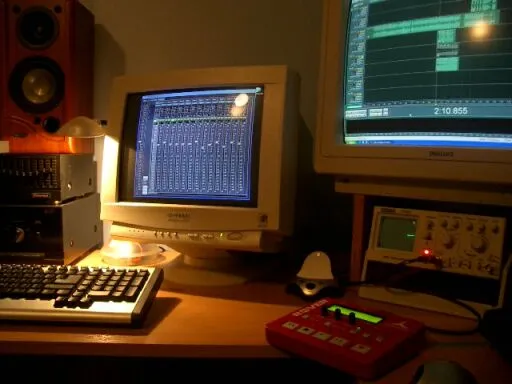

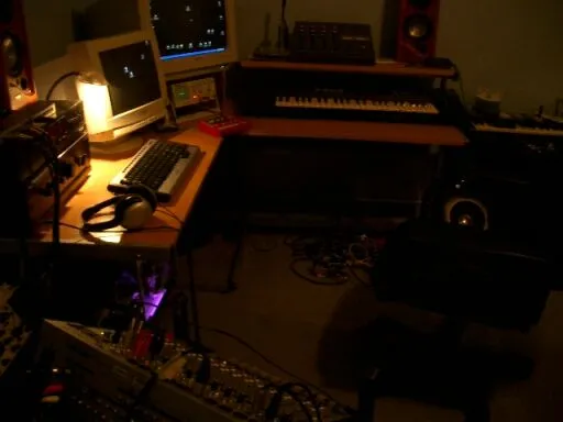

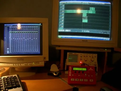

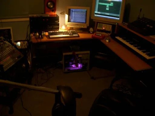

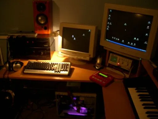

Hi! Just thought I'd get your thoughts on my home studio!!!!
  • Thread starter Thread starter superspit
superspit
superspit
idiots unite!
Hi people!! Great site.......learnt heaps!
Can I run my 5hit past you?
OK? Here it is.
Hasn't cost me a lot......but it's capable of doing anything that I may want!
Everything is based around two Delta 44's and Cool Edit Pro 2.1 .....just that I stopped using it's 'mixdown' system in favour of using an 'external' desk.....more fun.....and in my experience works better!! (for me anyway!!)
Hope pics aren't too dark for you....flash up'n'broke!!!
Please ask questions, if u like,....it's often easier that way.

Question 1: If you've learnt heaps, why are you mixing in the corner?
Question 2: ....why do you have the monitors at 45 degree angles when thy should be 60?
Question 3: Wheres the acoustic treatment?
Question 4: What mics do you use etc?
Question 5: What do you record/mix?
can't think of anything else atm :D

Sorry but wtf? Don't you care that you can't properly hear what you're mixing? If you mix in the corner(where the bass builds up)you'll hear a lot
more bass in your mixes and will EQ to suit that environment, then if you take the mix elsewhere it will have no bass. Your mixing position should be an equallateral triangle with the speakers, meaning that they should be angled 60degrees, if not then your stereo imaging will be screwed and you'll again mix to suit that environment, then if you take the mix elsewhere the stereo imaging will be scrwed. Thirdly, acoustic treatment is installed to even out your rooms frequency response so that again you can properly hear what you are working with. A flat room response with flat freq. mics and flat freq. speakers will give an accurate representation of what you are recording, and this will allow you to(along with experience)mix for any environment. And no, EQing doesn't solve the flat response problem. Because in just a couple of inches the rooms response totally changes. So if you EQ you have to keep your head in the exact position that you placed your mic to get the frequency response.

superspit what do you use the oscilloscope for?

I use my scope, I have 2 of them, to monitor my low end. I find myself sometimes mixing down at very low volume levels, so the scope assists me in 'seeing' my bass freq comparitively with other recordings. I look for a certain 'picture', within that scope. By doing this I find that 9 times out of 10, the next morning when I playback, it tends to work very well.

i'm no acoustical genius, but wouldn't reflections off of a parallel wall resulting from positioning monitors on a flat wall facing a flat wall be worse than monitors near the corner?
and though the monitors are in the corner, he is not listening in the corner, and the monitors are not facing the corner to directly reflect the wavs. though i guess sound vibrates in all directions, the majority would be forward and not back against the wall.
