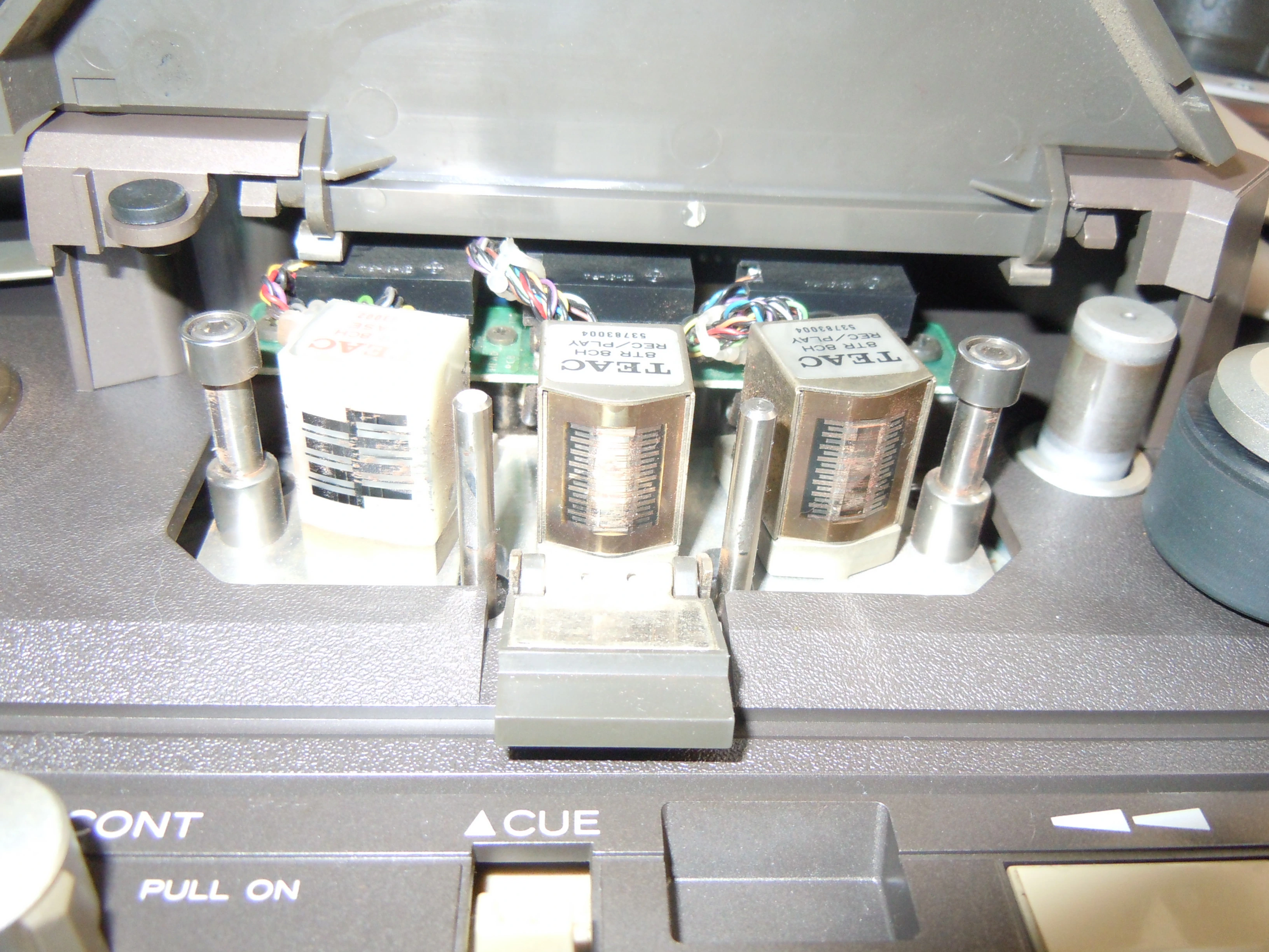

Just found a good deal on 2 Tascam 38 machines, however having asked the seller for a picture of the heads I'm not so sure, they look like they could do with a very good clean but I'm afraid it looks like the heads are opening up?

Only the second pic is there.
Yes the tape path requires a good clean. Unfortunately from my experience if that crud is sticky shed material and has been there for a long time, it may have damaged the head faces, requiring work on the head or even replacement.
Impossible to tell if the heads are "opening up" from that photo. That requires a very good, very macro photo of just the heads which that one aint.
The Tascam 38 is a pretty old machine. You may have problems with a worn out belt and dead channels to name a couple of likelies for this model. Also, if you are after tape distortion, its older electronics may not be up to it with the modern +9 tape types. The less high output tape types suit it better especially if you plan to deliberately overdrive the tape.
Cheers Tim
Aside from the gunk the picture isn't that great. The playback head looks like it has a little wear, but evenly. Need a cleaning. Note, the Tascam heads are socketed, if you had to you can get them relapped. You didn't say your location, I can recommend places in the USA and UK. I had a 16 track head relapped for about US$120.

Apologies they are the only images the seller sent me. The second photo is from the main machine the other machine is slightly worse on the SSS problem, both need a good clean but the heads don't look too bad :)
I'm in the UK, I've had a quote for new heads at £550 (+20%) each :O but hopefully at the most they'll need a relap in the future :)

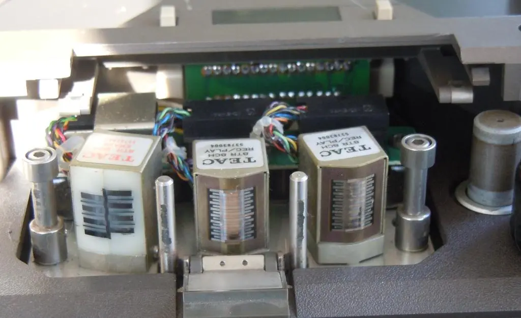

Hopefully it will work this time, here is the first pic from the "parts" machine - missing tension arm sleeve and head cover

That picture in post #6 looks quite a bit clearer then the first. The lifters seem to have the most wear but it looks pretty light on the erase and play head. The sync head is hard to tell because its a head on angle to the camera, so it might look worse in the picture then it does in person. If you can get the lifters and guide posts rotated to a clean arc, they'll be fine. And the heads look OK too.
Cheers! :)
Cheers! The pic in post #6 is the second machine that's missing a few parts (head cover and tension roller sleeve) however if the heads are better on that machine then I'll swap the parts over. If both machines are useable then I'll sell the other machine for someone else to get the use out of :)

No way to know for sure (condition) because there's know way to know if the guides and lifters have been replaced or if the headblock is off of another machine but if we assume the parts machine headblock is native to the machine and the guides and lifters are original then I see even nominal wear, means there is life left and I bet they cal up just fine which is the true test of whether or not a head is good or not...will it calibrate to spec?

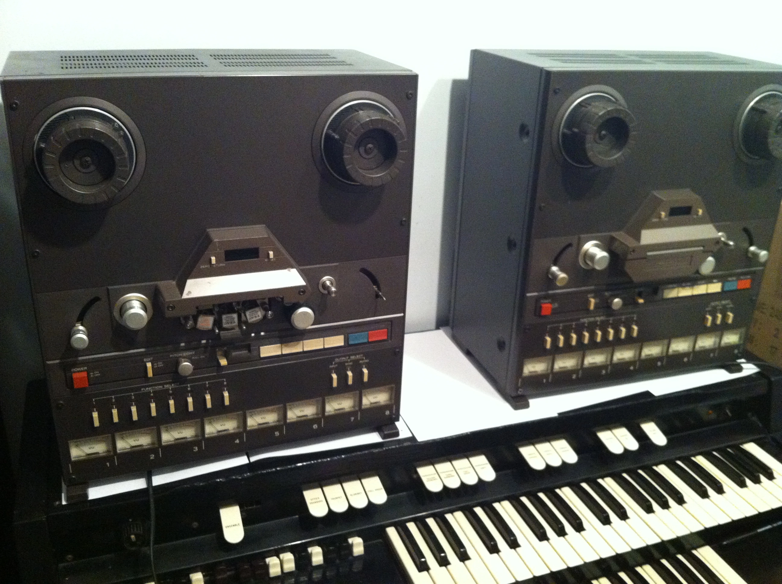

Hi all,
Well after a 6 hour drive and 260 miles later I'm finally home with the 2 T38's. Tested both machines as best I could at the seller's home, machine 1 worked well in all respects, machine 2 capstan wouldn't spin so I guess it's a belt issue?
Now I've got them home I've set up both, machine 1 still works fine but playback slows down to a crawl and I can hear a whirring noise inside, could it be the capstan belt? I know I need to clean both capstan posts too
Tomorrow I'll go through both machines and clean the tape path fully and see what else I can get :)

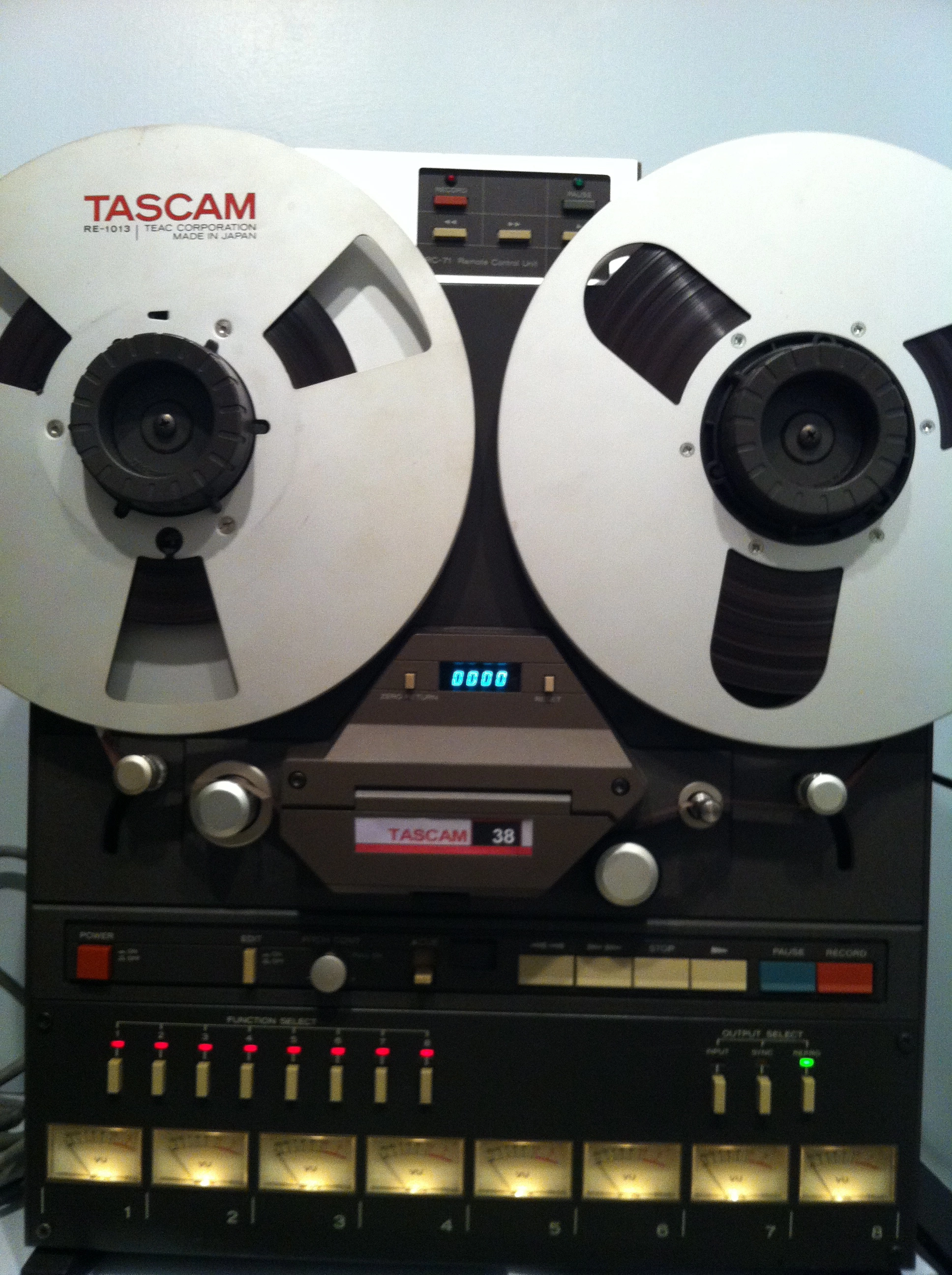

Here's a pic at home:
Yeah, check the belt on the dead machine. For slowing down, it might be the belt if it's becoming loose, but I would also check what tape you're using. Old Ampex stuff that's gone sticky will cause this kind of problem. If it's still doing it with brand-new tape, I would suspect the capstan belt.
Another possible suspect is the pinch roller. First make sure it isn't dissolving. After that, see if pressing it upwards during play magically fixes it. If so, it might not have sufficient pressure.
