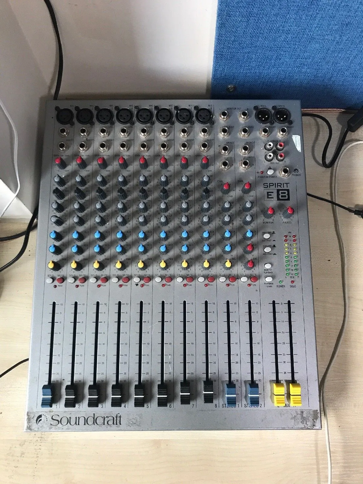

Hi Dave thanks for the info, I managed to pick this up on ebay today and a near new shure sm57 1.webp
So here's hoping it will sufice.Didn't want to go mad on expense at this stage.

Well by my lights you HAVE gone mad! Don't know what it has cost you but I was thinking $100-$150? Still, nice mixer I am sure and enough mic channels to "do" a small band.
You will need to buy or make some cables. TRS jack to RCA and XLR to RCA I think or you might be able to run stereo in and out from the four RCA sockets. When you interface a mixer with a soundcard for recording and monitoring you can get a feedback loop (not mic feedback) so after cold plugging up, always advance faders slowly from nothing and listen!

Thanks Dave valuable information on the set up really appreciate that, I was really unsure as to which cabling/leads to use.
I only paid £70 for the mixer and £55 for SM57 (used but good bargains) So keep you posted when it all arrives.
