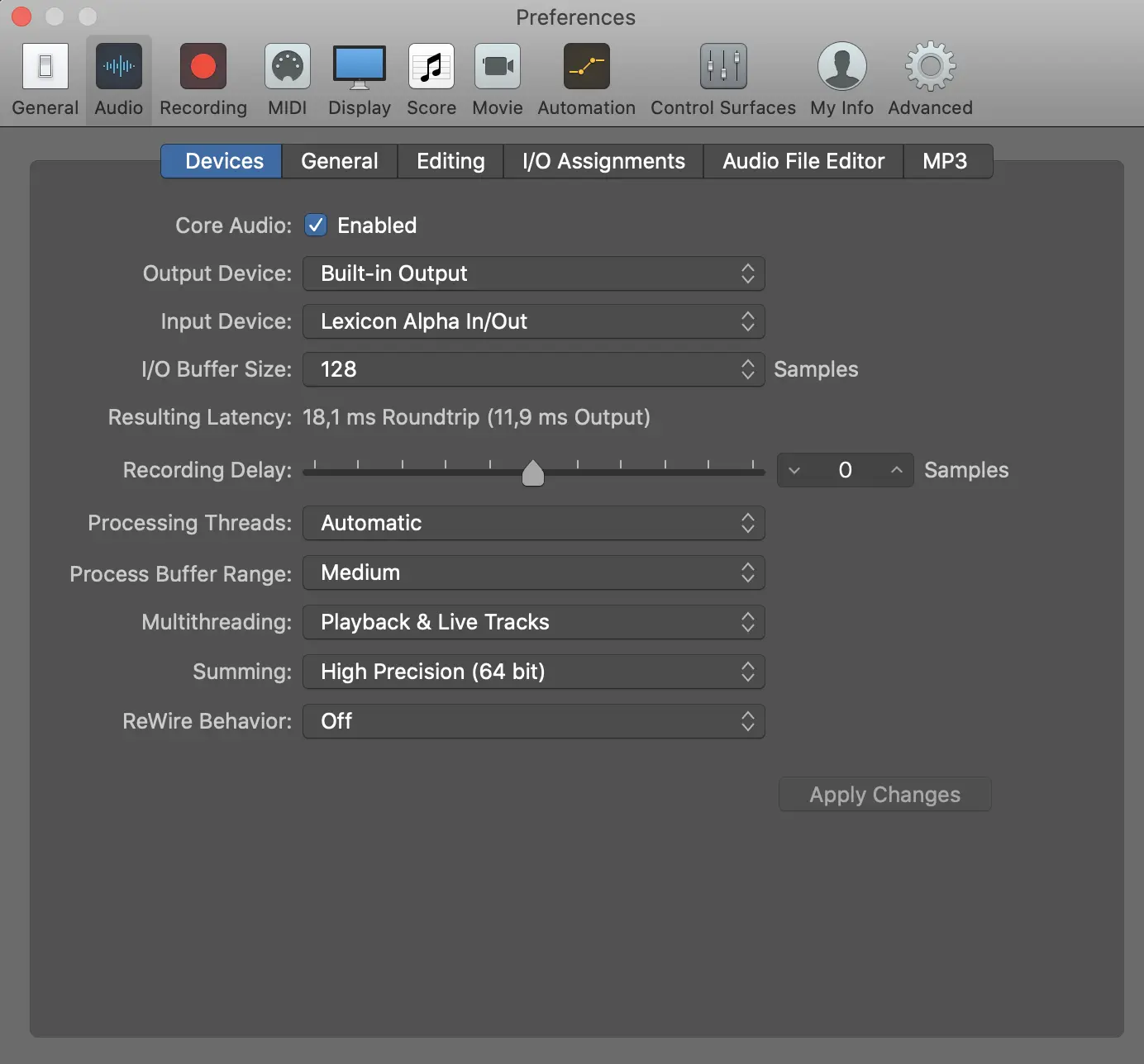

I took a screenshot of my Audio settings in Logic. The weird thing is that Logic finds/recognizes the Lexicon, but it won't record/receive any sound coming from it.
And when I select the Lexicon as my output device, I can't hear the signal coming out of my headphones that are still plugged to the front of the Lexicon.

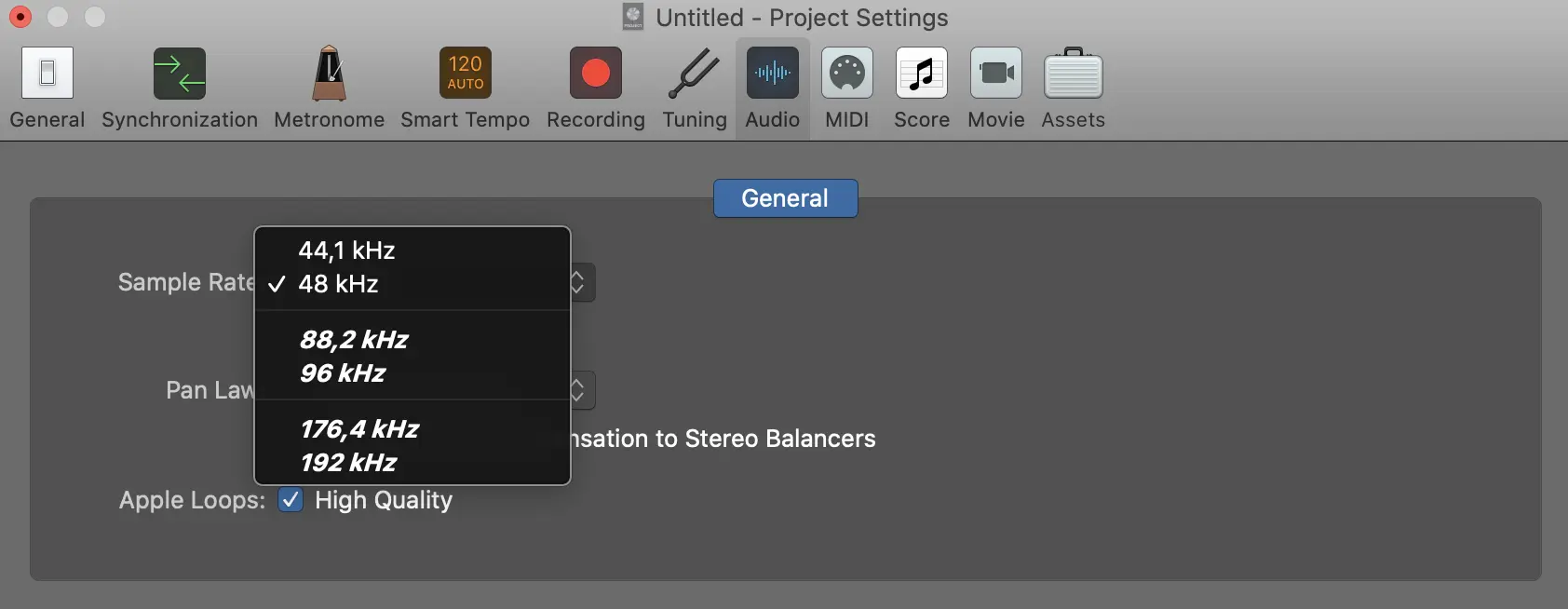

I made some MAJOR improvements in the meantime : I tweaked the Sample Rate from 44,1 to 48 kHz, and I'm now getting a signal within the DAW, but it's _super_ distorted, like my Mac/the Lexicon are not able to process it...
Do you know if this is the right solution to my problem ? And if yes how I can fix this new problem ?

All I can think of is that you have the buffers set much too low. Don't want to slag off that interface but it IS getting on a bit! The early USB AIs were not noted for low latency and needed a high buffer setting. But then macs handle audio differently from Windows so I don't really know?
I note that on your screen shot you have Lexicon slected, but on your output device you have "built in output".
What you should be aiming for is to have your output also go through the Lexicon, and have headphones and speakers connected to it.
Thank you to both. I SOLVED IT.
Dave I have set the buffer to 256 samples, and Gecko I have selected the output through the Lexicon.

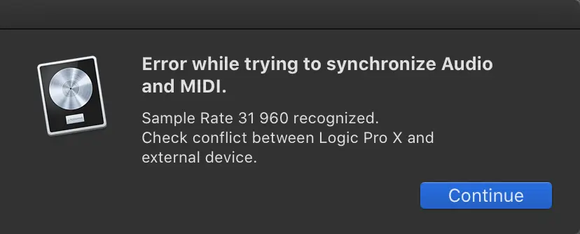

I started having an error message : Error while trying to synchronize Audio and Midi. Sample rate 31960 recognized. Check conflict between Logic Pro X and external device.

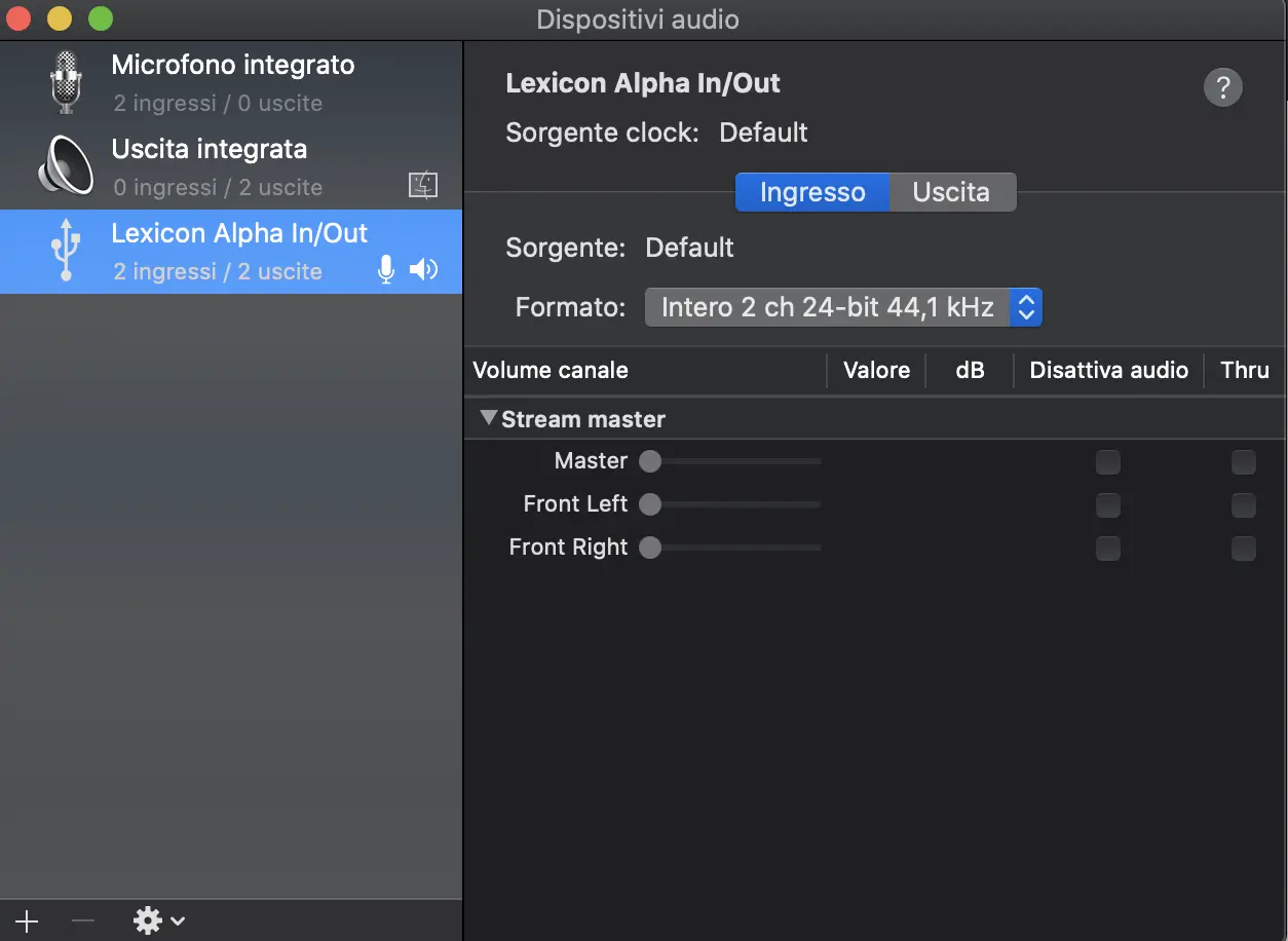

But then I looked a little bit on the internet, seemed to have a similar problem to this guy right here : discussions.apple.com/thread/7583277
And I finally managed to solve it by going to Utilities > Midi devices, setting everything back to 44.1 kHz.
I then restarted my computer, and everything seem to be working just fine now.
