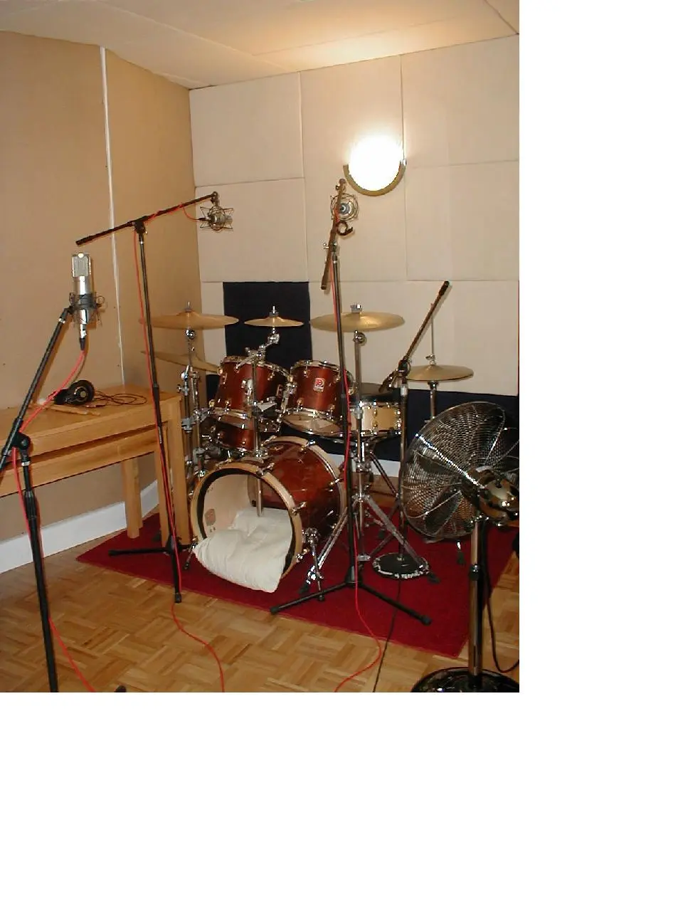

Post your studio pic here.
In fact, I'll post one too... It's a corner of my unfinished studio... You guys don't get to see my control room though... Not yet anyway...

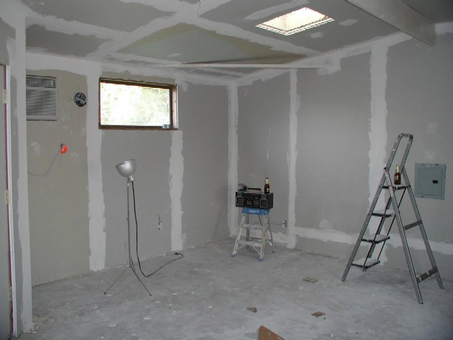

Here's mine. Still workin' on it, but getting closer.

Nice looking drum set.

That's an exterior wall... So what's NOT on that wall?
First we have the exterior house wood paneling. Then a non-insulated standard 4" wall. Then an insulated (703) standard 4" wall. Then 3/4" plywood on the inside of another standard 4" wall frame, but positioned to form a triangle with the insulated wall with a 1' gap at its tip. On the other side (the side you can see), that's 3/4" HDF board with a 2X4 fastened vertically in the center to each of the HDF. Memtech Sound Barrier was fastened edge to edge of the HDF on that side.
Yep, DAMN massive wall + air space + air-tight = Soundproofing.
If only I could have afforded to do that to EVERY wall... And pro doors!!!
This wall will soon be 100% covered in Auralex MiniFusors.
Nice looking piano!

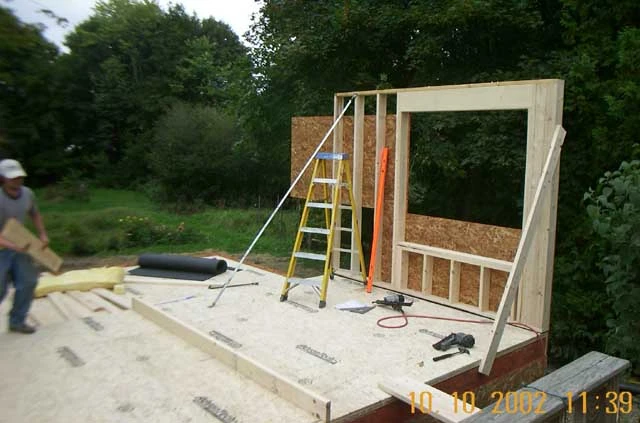

here's mine. :-) I, on the other hand, WILL show you my control room, however it's currently looking rather like the emperor's new clothes. It's right about where that roll of neoprene is...
Hey alex, is that an iso booth on the left? got any more pics?

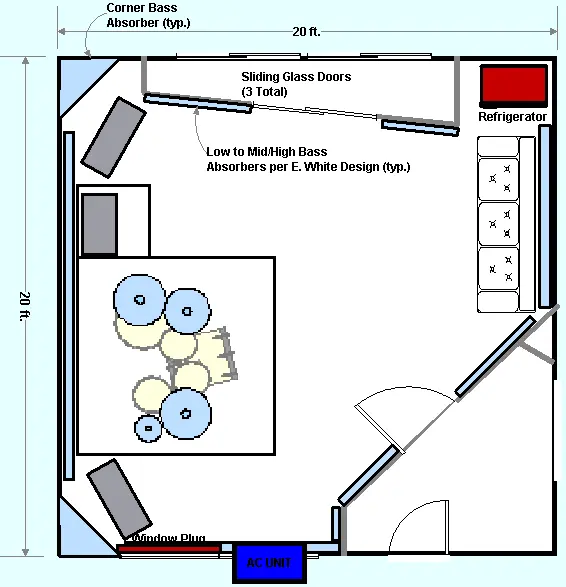

Dan,
That jut-out on the left is just the entrance cubicle. Separates the "jam room" off from what will be my wife's future home office. Here's a plan for the whole thing.
Alex
make sure to supply the beer upon COMPLETION of the job...secret of the trades...
