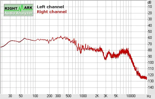

There is a 60/120 Hz hum in there but no big spike on the spectrum but the average level is way too low, around -45,-50 and it just about peaks to -20dBFS.
This tells me that the mic level is way too low and gains are being cranked and hum and noise, probably in the mixer, being brought up. Is the lapel mic unbalanced perchance?
