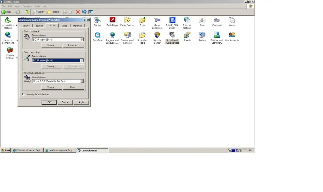

is the correct device selected for system playback in control panel>sounds?
sonar etc would work regardless of this because you select their audio device in their own settings page.
Thanks for the reply, I went back into Sounds, and the attachment here shows what I found,
E-DSP WAVE 480 (E480) is the soundcard, (E-mu 1212M), I believe, and is the only option there, however, the default media player for my MP3 collection is Nero, I'm unsure if that's significant, but thought it might be worth mentioning.
Does that tell us anything?
Thanks again.
