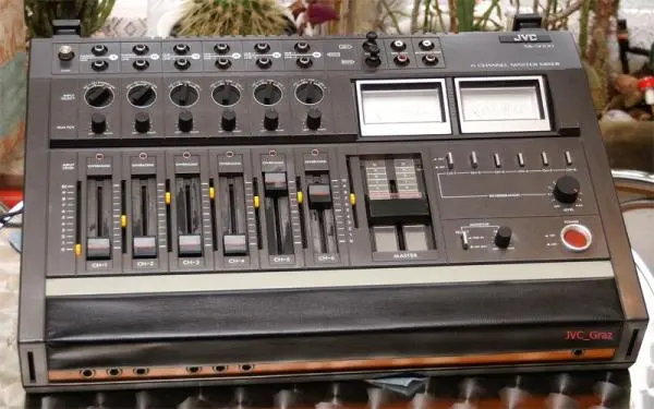

5 mics don´t go "straight" into a tc 377 - it has 2 line ins and 2 mic ins, right? There has to be some mixing console involved and you´ll probably have to give the mics enough "gain" on there. But please, give us more information on your setup ...
Claus is correct you can't just plug five mics into four jacks on this Sony. You need something like this: (from hifiengine, who has the manual)
I still have one of those and used it with a Sony TC-277-4. 1/4" jack, cheap mics in and all.
You could use a Shure M67FC or 68FC mixer as well those are 4 into one. Get you a grungy sound though.
