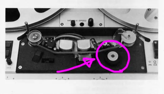

Hi there,
I have a PR-99 which seems to function as expected without having tape threaded, but when I press play with tape in, it clicks, moves all the rollers and tried to take up the tape but it can't.
If I use my finger to stop this roller from pinching the tape, it reels the tape through as expected, but I'm assuming the purpose of this roller is to squash it against the other one which feels like some sort of flywheel, to keep the rate of tape steady, yes?
Any ideas?
Thanks,
Mark
