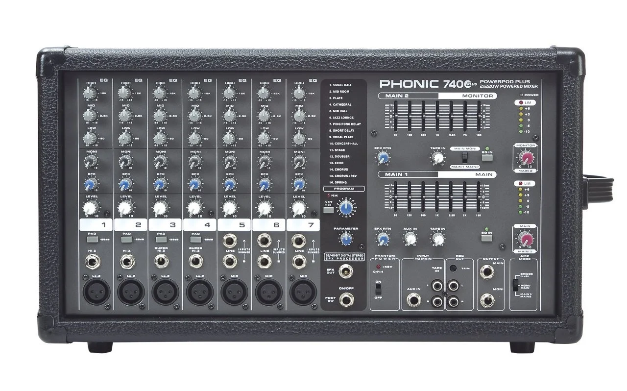

I own a Phonic Powerpod 740 Powered Mixer. 7 channels.
Channels 1 -4 each have Lo-Z XLR inputs. What equipment would I use those for?
Channels 1 & 2 have 1/4" Hi-Z inputs. Channels 3 & 4 have 1/4 Super Hi-Z inputs. What equipment would I use those for?
Channels 5, 6, & 7 have Mic XLR inputs and dual 1/4" Line "A B inputs summed" inputs. What equipment would I use those for?
What are the Pad -25dB buttons for?
What is phantom power, and when/why would I use it?
I'm currently using passive speakers and monitors. How would I use active speakers and monitors?

What you've there is a cheap (but large) PA powered mixer.
Channels 1 -4 Low-Z microphones plugged into the XLR jacks
Channels 1 & 2 instruments (guitars) plugged into the 1/4" jacks
Channels 3 & 4 instruments (guitars) plugged into the 1/4" jacks
Channels 5, 6, & 7 Mics into the XLR connectors or line level signals (keyboard, MP3 player, etc) into the 1/4" jacks. Dual-summed means if you plug a stereo keyboard (for example) into the A & B jacks, they will be summed to mono in that channel.
The only way to use this with active speakers would be to adapt from the 'REC OUT' line outputs which are really designed to go to a recorder of some kind.
Can I ask how you came across this (and have passive speakers and monitors) and don't know how to use it? :eek:

As for phantom power, it's just needed for certain types of mics. If your mic works without it on, leave it off. It won't be problematic if you have it on when not needed, but if a cord is broken or whatever it could potentially damage your mic so it's good practice to have it on only when needed.
Microphones, direct boxes.
1 & 2, instruments with active outputs (keyboards, guitars with preamps). 3 & 4, guitars etc. with piezo or magnetic pickups but no preamps.
XLRs, mics and direct boxes. Summed line inputs, stereo line sources.
If something is so loud you need to turn the channel level knob almost all the way down, try the pad.
Use it for condenser microphones, active direct boxes or anything else requiring phantom power to operate. Don't use it for certain ribbon mics and/or if you have a faulty cable.
Use the Main and Mon line outputs on the front.
