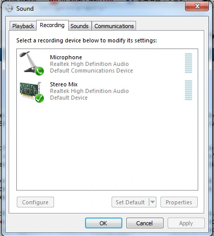

Is this what I'm supposed to do?

Hello, I was trying out again with my old mic and the old mic automatically takes over the function of the laptop mic. But it doesn't work the same with NT1A? I've tried setting the default back to "Microphone" but it still doesn't work.
Go back and read my post about right clicking on the right area of that screen and making sure there are ticks on Display Disabled Items and Display Disconnected items. If not, tick them then see if a second microphone icon (for the socket) pops up. If so, select that.
If not, all I can think is that the 3.5mm adaptor is wired in a way to be incompatible with the sensor in your laptop that switches over the inputs.
