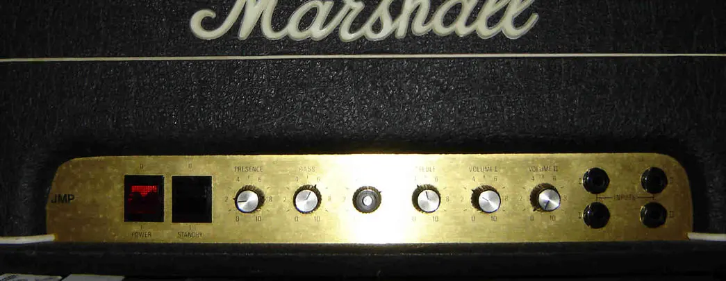

I need some advice re tone for guitar...there's no master volume, just presence bass mid treble & a volume pot for each of the 2 pairs of inputs.
I used an overdrive pedal in front with level and gain at 12 o'clock on one track and the same pedal with about 3 o'clock level & no gain on a second. I did the 2nd because I fugured the gain in the pedal was probably some cheap simulation.

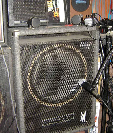

What do you folk recommend I use as settings to get a good o'driven rock tone from a single coil semi acoustic guitar? I'm not after metal or any specific genre, just that lovely sound of a tube breaking up. I did have an attenuator but discovered that such things and Mrshalls generally aren't compatible so am looking for a new way. Attached are pics of the front panel and the mic'ing set up I used most recently - oh, you'll note that I'm using a 200w Etone bass cone - not optimal for guitar I suppose.

Maybe try the old Plexi trick of patching the inputs together and crank it.
Greg, I used to do that when I had the attenuator attached. I guess I still can , it'll just be LOUD. But then again it's meant to be & a 57 should be able to handle it.
Those old non master volume Marshalls need to be cranked if you want any type of tube breakup. You also might wanna consider getting a proper speaker cab. Then buy a house with strong walls and windows because that thing is gonna be LOUD.

I think the biggest thing you could do for yourself at the moment is get a cab with some decent speakers inside. Speakers are a good 40% of how an amp sounds. My mesa sounds way different through some T75 speakers compared to my vintage 30s.
Same with a AC30, that amp sounds way different with alnico blue speakers than it does with the standard greenback.
If your still not digging it after that (and my guess is you will). Then I would reach for a pedal.
I've the cab thing sorted as of today but that doesn't address the sound I'm after which is the sound of the tubes cranked/overdriven.
