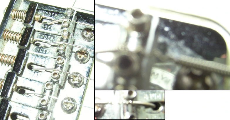

This isn't really recording based but I'm hitting my head against a brick wall with this. I have a guitar sitting at my place from a friend, he just leaves it here. Well, I have another good friend of mine come over and we jam, and the guy uses the guitar that's there. He's busted the thick E string 3 times. Not the usual snap though. Near the bridge, the string is normal then it very thread like then goes back to the normal string thickness and the string is loose and unplayable. It just happened again for the third time.
I am putting these strings on correctly, I play this guitar all the time, so do other people, they never bust it like that...or even snap it. The guy's older brother is a bass player and claims I must be putting it on wrong, but I know I'm not, this is just driving me nuts. Probably the guy's technique, it's always in a power chord song. The strings are "D'Add..." I can't spell it, I'd have to go find the package and their "super light". Now I'm 15 years old and poor I can't keep buying packs of strings and the only place that sells strings separately is not walking distance (I don't drive yet).
So I don't know if the strings are too light (even though no one else busts them) or his technique is wrong. I'll take a picture of the string when i get the time, but please try to help! Thanks.

It sounds from your description like they're unwinding. One cause of this could be that particular string's saddle on the bridge. Check it for sharp or jagged edges, which can VERY GENTLY be filed down (since you don't know much about this, just have the owner do it or take it to a shop). You could also try a different guage that might fit the saddle better.
Basically those light strings are wimpy. A player with any kind of right hand will break through them regularly. While it is sort of rare to break the low E, it does happen. Those wound strings will usually break by unraveling, so it's hard to tell where the break really occured.

Hopefully this works, attached should be 3 pics of the unwound string and the bridge.

I would try heavier strings, and more pick angle. I know it's not easy to tell someone to play differently than they play, but breaking strings like that is kind of hard to put up with. Definately try a heavier set next time.
Those older style Fender saddles are total ass. They should be replaced with Graphtech saddles. That and heavier strings will eliminate a LOT of breakage.
Definately a combination of techniqe and string guage is causing that.
Buy a set of .10's and tell your bud to chill on the strum.
I'm not surprised the saddle sucks, I was looking it over and there isn't much place to set the string in, just a small gouge...and it didn't even really still look right. If this was my guitar I'd replace the bridge, but it's not. Hopefully my friend will just buy his own guitar.
I asked him about it today and he said he was actually strumming a lot lighter. I dunno, thanks a lot.
Those type saddles end up with a groove from wear. Get a small file and round out the edges, don't go any deeper than it is but widen the groove and follow the profile, or radius of the saddle. It shouldn't take more than a few cuts.
Try using string gauge .052 - .010, these are known as "skinny top, heavy bottom", they should solve a lot of the problem, but my guess is it's a combination of string pinch in the saddle and heavy hand just cuts like a shear.
