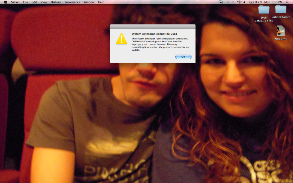

Help me with this error please

I tried that but it said system extension not found. And yes i am on snow leopard and i am running logic 9 (paid full version) i tried the disk utility thing the first time it happened and it did not work either
*edit*
googled it...
this kext version isn't compatible with Snow kitty.
update spin doctor....it comes with toast i think?
1. It should be "/System/Library/Extensions/CDSDAudioCaptureSupport.kext". HFS+ can be case sensitive, depending on how you installed your machine. Always good to be pedantic. :) And you made a typo in the name of the KEXT.
2. Try this:
sudo kextutil -n -v 6 /System/Library/Extensions/CDSDAudioCaptureSupport.kext
Tell us what that spits out. If you don't have kextutil installed, grab a copy of the Mac OS X developer tools and install it. You can either download one at:
http://developer.apple.com/technologies/xcode.html
or install it from your Mac OS X install DVD (at least I think it's on there).
turns out permissions are irrelevant man,
it's a recognised problem where the kext isn't 64 bit compatible and the software has to be updated.....apparently
Are you running Mac OS X Server? No? Then it's not a 64-bit issue. Mac OS X 10.6 Client (the non-$500-per-copy version) boots with a 32-bit kernel by default, regardless of hardware. The only way you would be running a 64-bit kernel is if you explicitly enabled it, in which case you can always disable it again. :)
