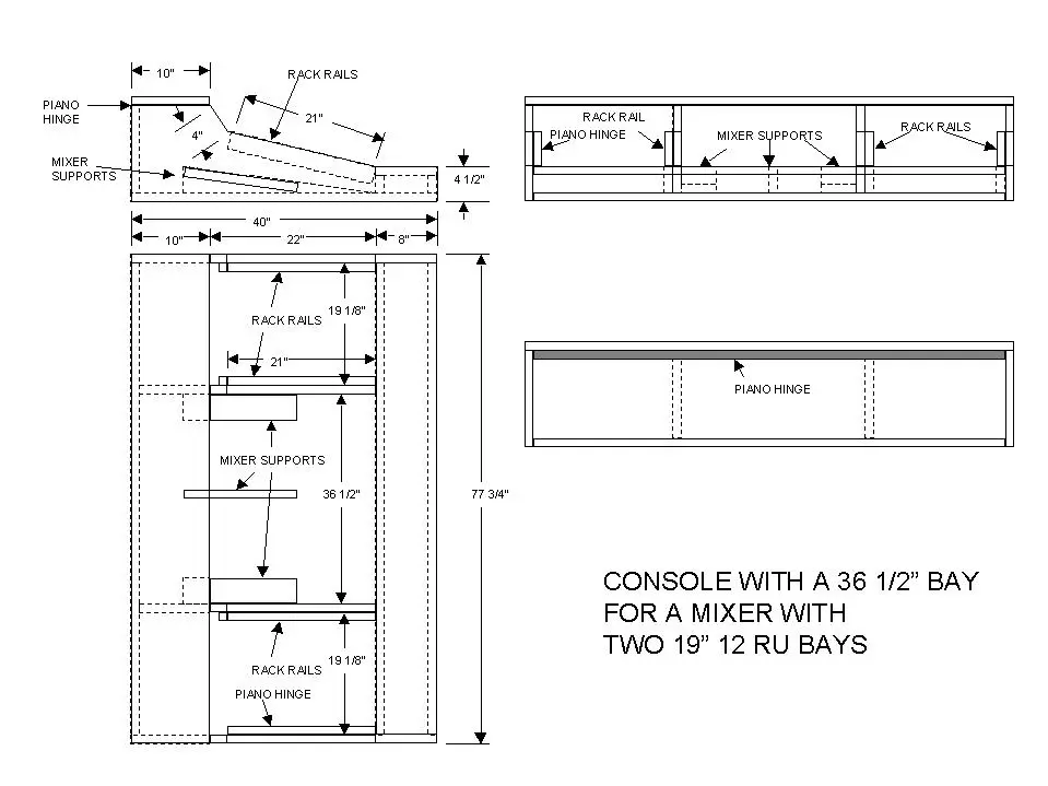

Track Rat Just Your Average Sized Member Apr 24, 2003 #6 OK, here we go. Attachments slide1.webp 20.5 KB · Views: 404

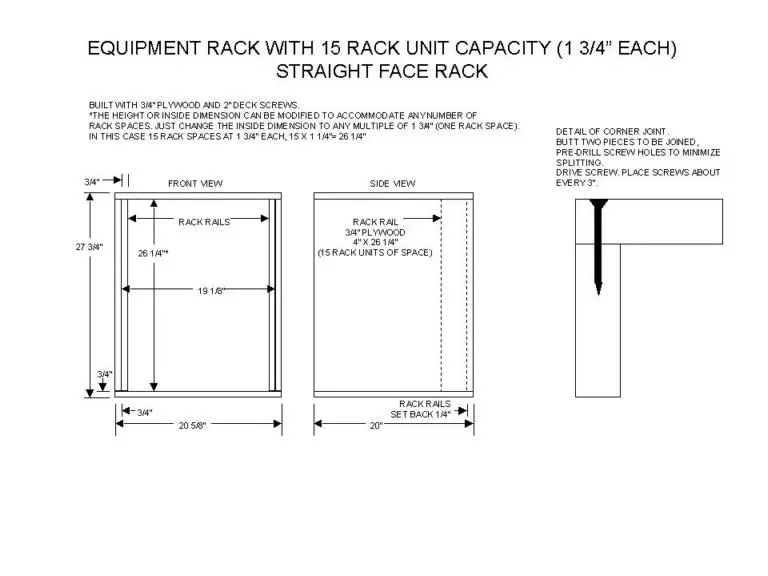

Track Rat Just Your Average Sized Member Apr 24, 2003 #7 Here's the next one. Attachments slide2.webp 23.1 KB · Views: 436

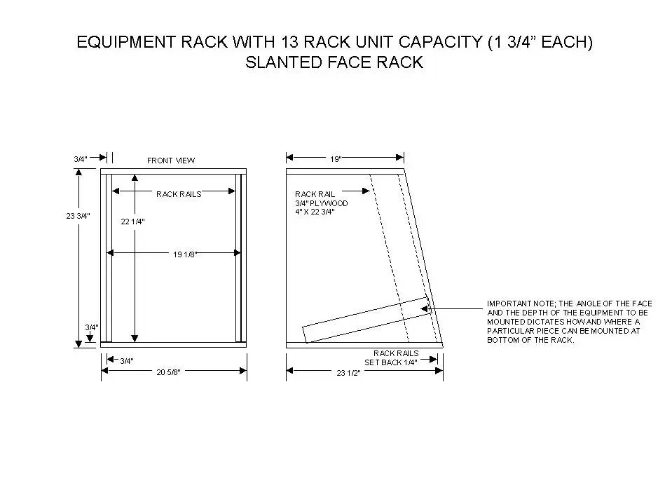

Track Rat Just Your Average Sized Member Apr 24, 2003 #8 And the last one. Attachments slide3.webp 31.3 KB · Views: 95
longsoughtfor Searching for the sound Apr 24, 2003 #9 Track - Are these the drawings of your stuff you were talking about? Kevin.
longsoughtfor Searching for the sound Apr 24, 2003 #11 Nice drawings - they look great! They are up: http://www.longsoughtfor.org/postn/...ame=gallery&file=index&include=view_album.php Cheers Kevin.
