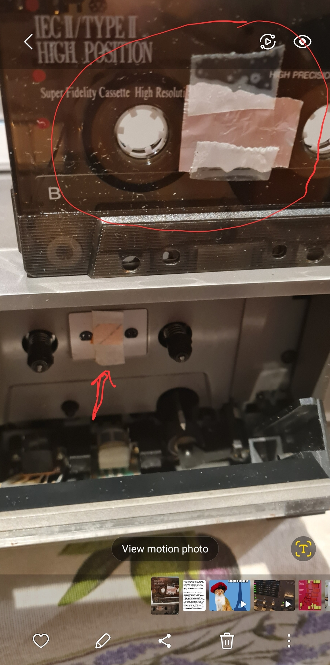

Regarding the seals, I can confirm that you can use any chrome tape, even the completely transparent ones from the 90s and later (which weren’t a thing in 1983 when MT44 went on sale). You block off the middle “eye” on the deck, by putting non-clear tape over it (e.g. thin surgical tape), then on those cassettes that you designate to be your “4 track one”, you put it up on its B side, take some kitchen foil, cut out a piece that will cover between the spool holes and attach with scotch tape at the top and bottom edge of your foil rectanghle. Recognised immediately!

As per my previous post, here's how this "seal" looks like made of kitchen foil with sticky tape, and masking tape on the machine itself (see arrows). Apologies about the dust in the pictures.
