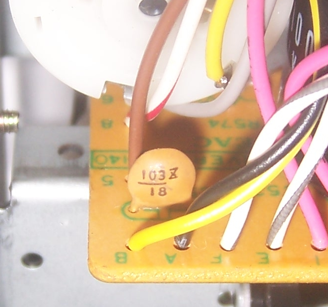

T tross1024 New member Apr 24, 2014 #1 I need a replacement for this ceramic cap, marked 103Z, 18. See pic. I know 103 on a ceramic cap means 0.01uf, but I can't find any info on that Z symbol. And 18 = 18V? Thanks.
Steenamaroo ... Apr 24, 2014 #2 The letter is likely to be tolerance and Z would indicate +80/-20, I think. However, that's not really a Z.
