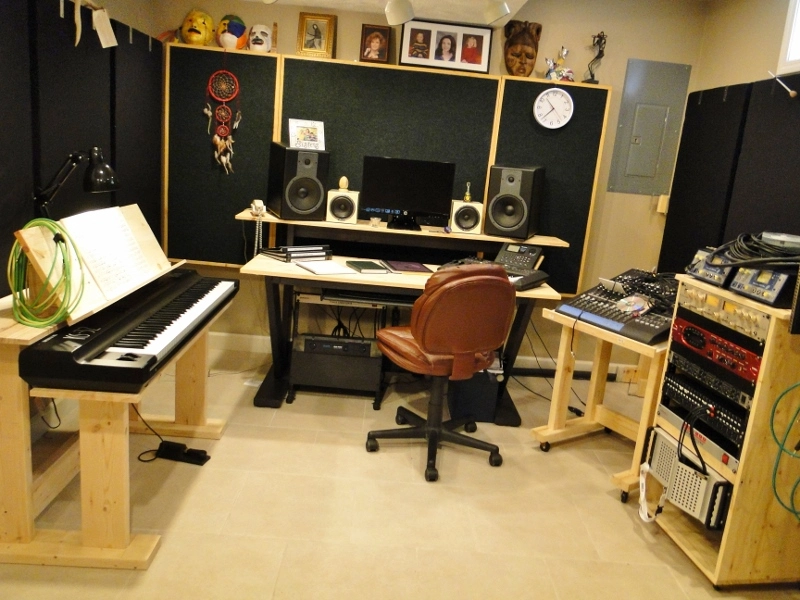

Below are more recent photos of my Home Studio.
Although my acoustic panel set-up is not as good as it could be, it does provide a good example of a fairly nice set-up for a home studio that can be improved upon with time and money.
The photo directly below is a "straight shot" towards my desk and shows:
1) The Wall Behind the desk is essentially covered with my Custom Designed "Black-Hole" Absorbers that primarily revolve around 8-inches of compressed fiberglass. To do this in a lower cost format, you could do the same by hanging 4" thick compressed fiberglass panels.
2) To the left and right of my desk are 6-compressed fiberglass panels, 3 to a side, that are placed, primarily at the first left and right reflection points from my Audio Monitors.
In any case, all of these can easily be removed from the walls and moved elsewhere.

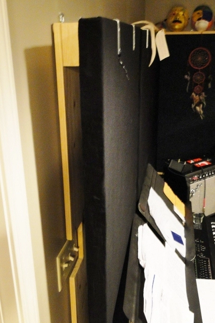

The photo directly below shows the wall to the right of my desk where you can see the compressed fiberglass panels as mentioned above as well as 3 multi-level panels I designed and built that utilize 8 of the 1ft X 1ft foam panels on each panel. As each panel is at a different depth from the wall, they create non-parallel surfaces across from the opposite walls that are flat-surface solid-wood doors.

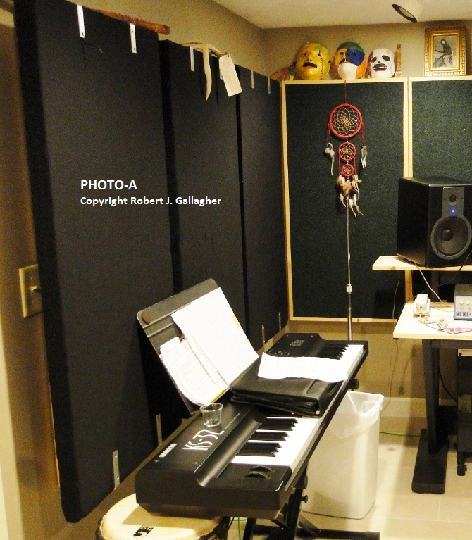

This photo below shows the rear and left walls
