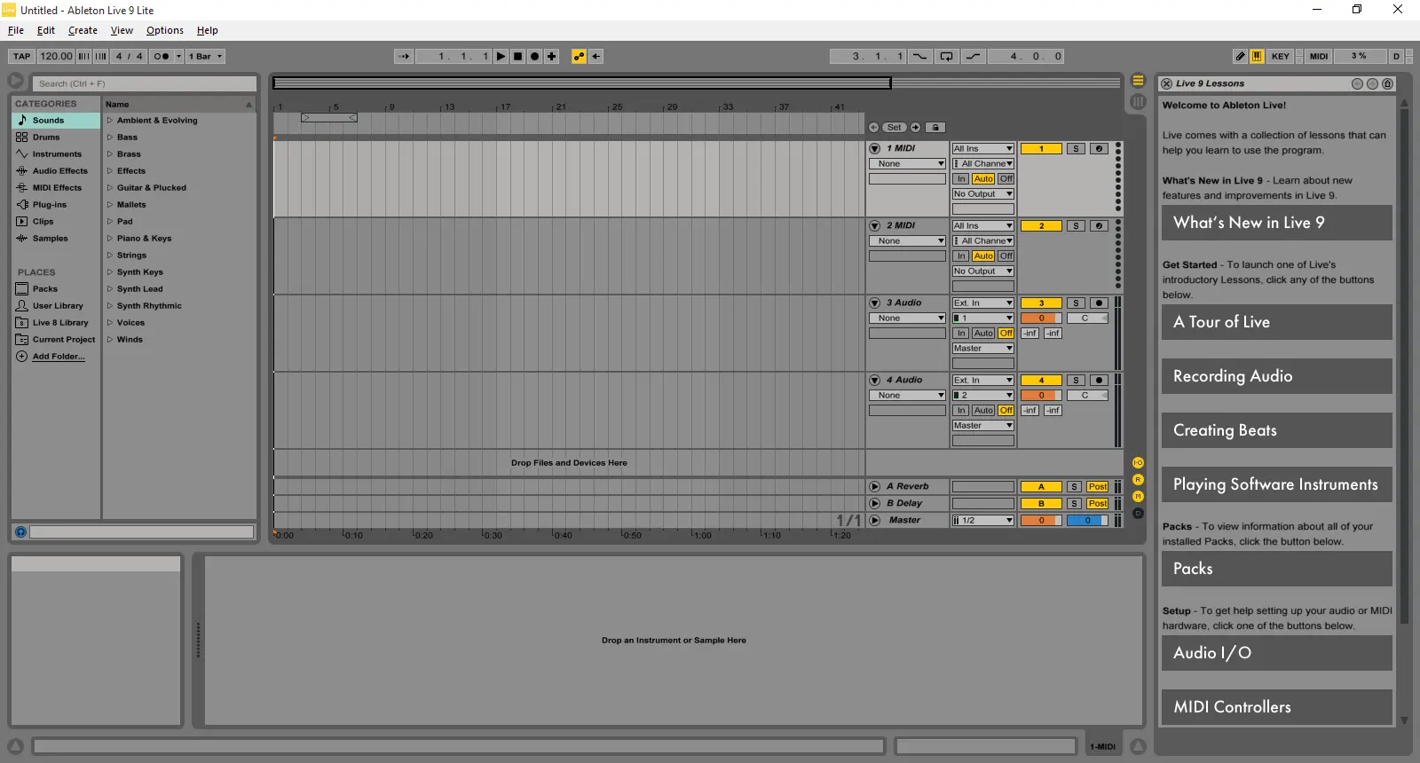

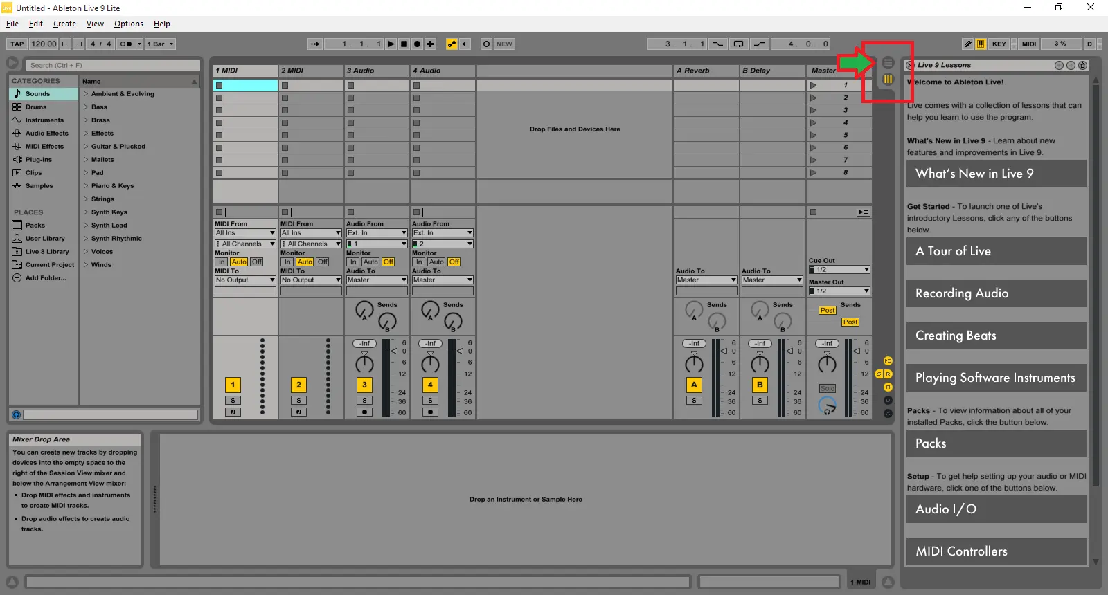

Ableton Live can do linear recording-- look for the two little icons near the upper right corner of the screen, one with three horizontal lines and the other with three vertical lines (see screenshot below). The lines represent tracks, with the horizontal lines indicating a standard linear type of recording, and the vertical lines indicating the clip-oriented type of recording/performing that Live is known for. So click on the icon with the horizontal lines to get a regular-looking DAW screen-- except Live likes to be different, so the track controls are on the right side of the screen instead of on the left side.
I used to avoid using Live because it looked intimidating and confusing compared to other DAWs, but after I took a free online introductory course I realized that it's actually very easy to use. However, the impression I got from using the "deluxe" edition of Live 9 on a trial basis is that Live is heavy on electronic virtual instruments but seems to be weak on acoustic virtual instruments-- e.g., I had trouble finding a decent "Acoustic Piano" sound. I have Live Lite 9, and my Live 9 trial has expired, so I can no longer access the complete set of virtual instruments to confirm, but that's what I remember from when I was taking the online course-- and other students mentioned it, too, so apparently it wasn't just my impression. Of course, you can always add external plugins-- but when a DAW costs as much as Live does, you expect it to come with a pretty complete and well-rounded set of virtual instruments.
