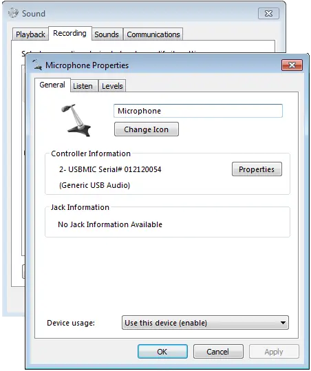

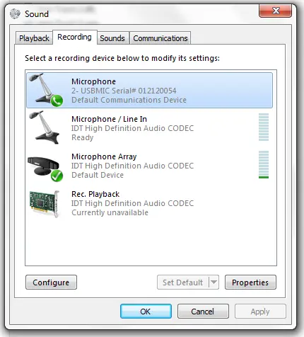

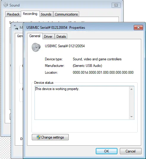

on and with the first time, a dialouge box in the bottom right showed 'drivers have been successfully installed'. I have tested
the mics individually in the mic port like I said and they work fine. But hitting the record button in Adobe Audition 1.5, the
recording program I am using, with the USB hub selected as the track's recording device, the program freezes and then tells

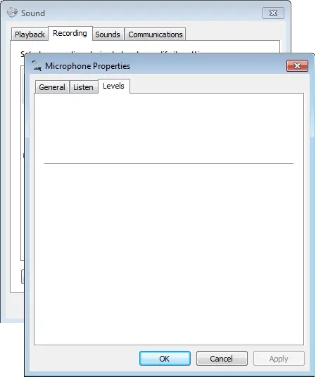

me there is an error. Upon further inspection of the device in the computer recording devices, no level is displayed next to
this particular device (as pictured) and cannot be used to record anything on the laptop as it is. It needs modifying somehow
and I don't know what to do. People have made this work on other computers by changing something in some 'advanced
menu' but I do not see where this is located... Please check my screenshots.

OK, first I would like you to follow the troubleshooting steps below:
1.) Try disabling all recording devices (IDT Microphone/Line in and IDT Microphone Array) except the USB mic. There should only be one active microphone.
2.) The next thing is to configure AA 1.5 to use this USB MIC. Follow the steps:
a.) Launch AA1.5
b.) Go to Multitrack view.
c.) Go to Options -- Device Properties -- Click "Wave In" tab. And then select the USB from the choices. Click OK.
d.) Then go to Options -- Device Order -- Click "Recording devices" tab and then make sure the USB mic is set as the first device (only device). Click "Use in EV" then click OK.
e.) Restart AA1.5
f.) Go to Edit View.
g.) Go to File -- New -- Select 48KHz, mono, 32-bit float then click OK. You will perform a test recording.
h.) While speaking to the microphone (make sure its connected to your computer), go to Options -- Monitor Record Level.
i.) If you see the level meters on the AA1.5 moving while you have enabled "Monitor record level", it means there is a received signal from the USB microphone.
j.) Finally hit the record button.
Note: You can also try removing other USB devices connected on your computer except the USB microphone while performing this test. I would also ensure that the computer has been updated (e.g. using Windows SP3) as USB drivers might be corrupted or incompatible with Singstar.

Hello! Thanks for your great reply! Sadly this does not work because the microphone itself doesn't seem to be registered properly, so it's probably the OS or USB ports... ah.
Thanks a lot! :)
