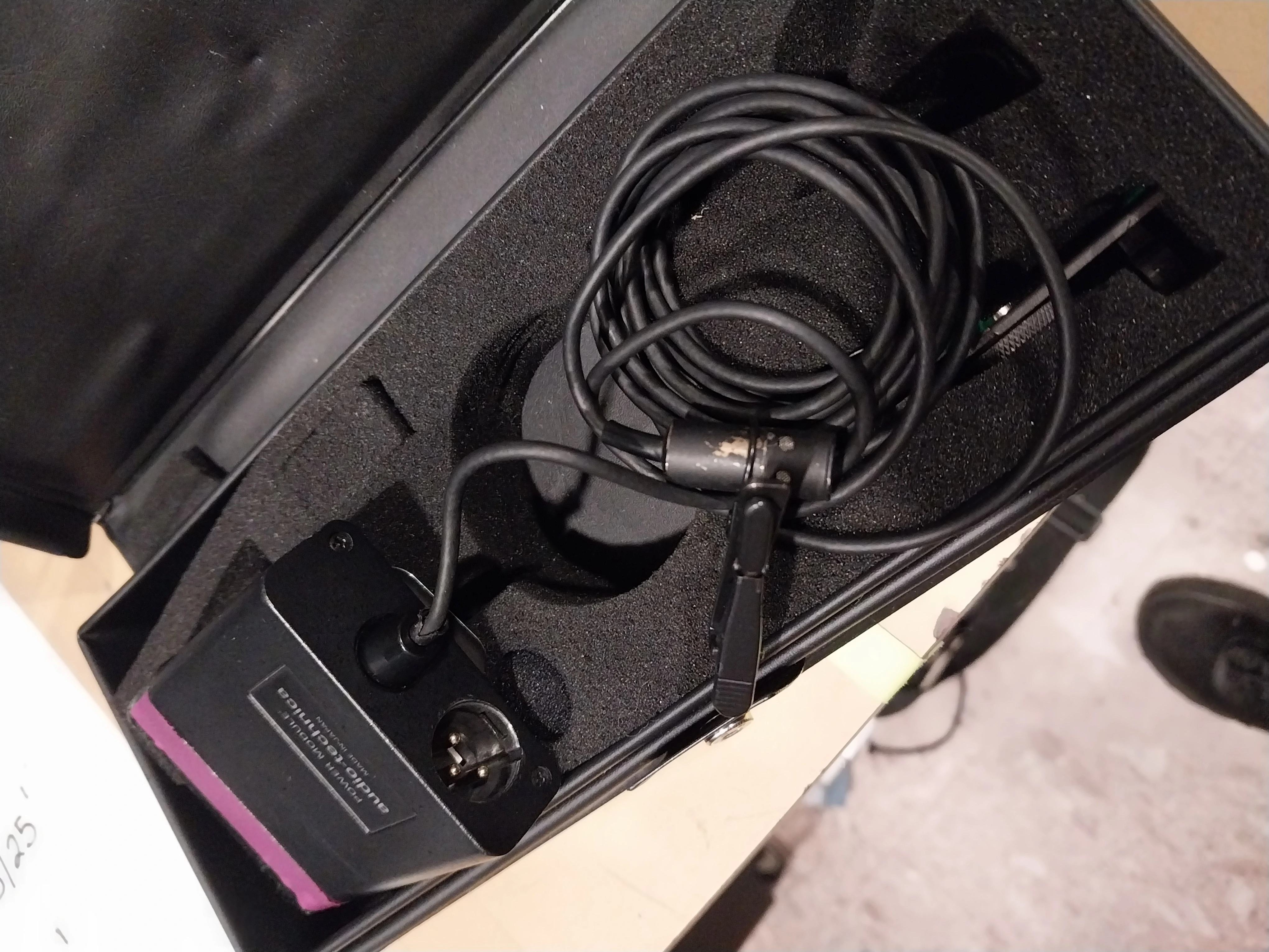

What about a lapel mic? Where I work we have several of the ones in the attached photo.
