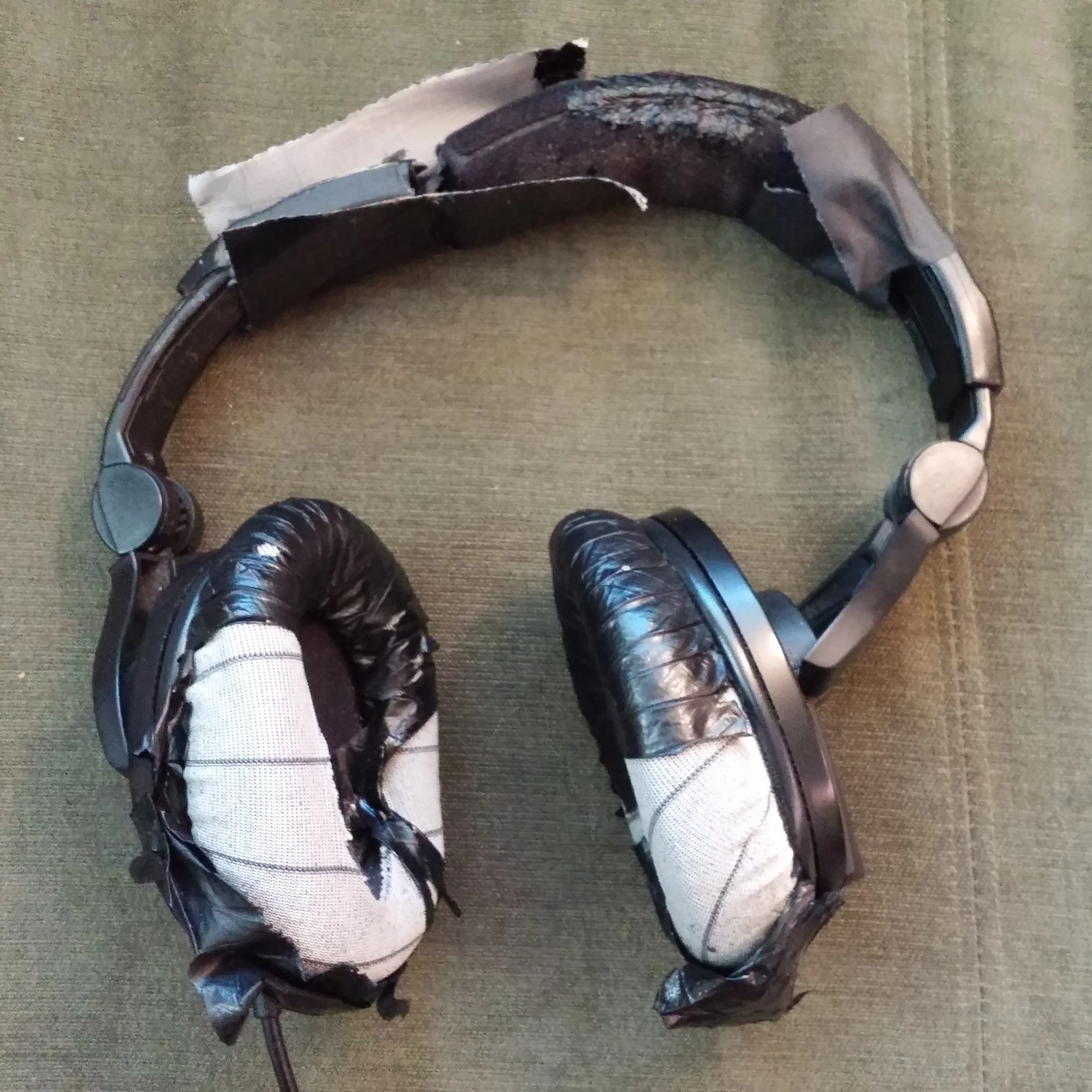

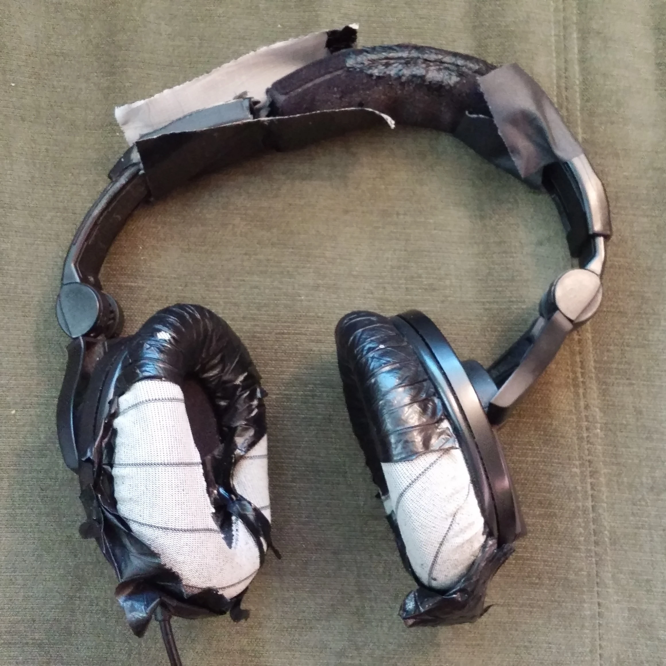

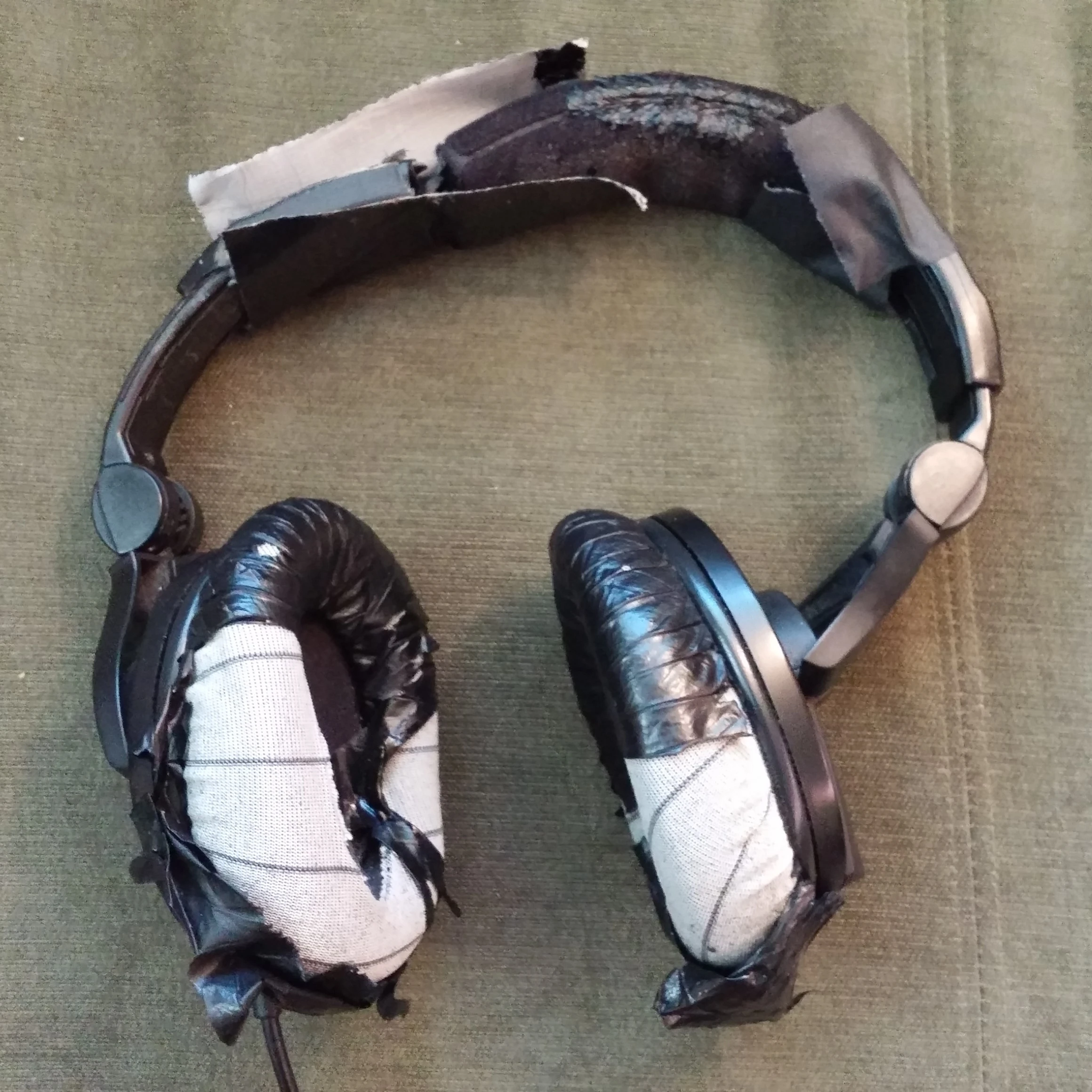

Happy to see Boulder's HD280s. Even though I sat on mine and broke them a couple of months ago, my gaffer taping is more tidy than his.
Anyhow, just measured the impedance on mine and got 59 ohms. Mine are about 8 years old.

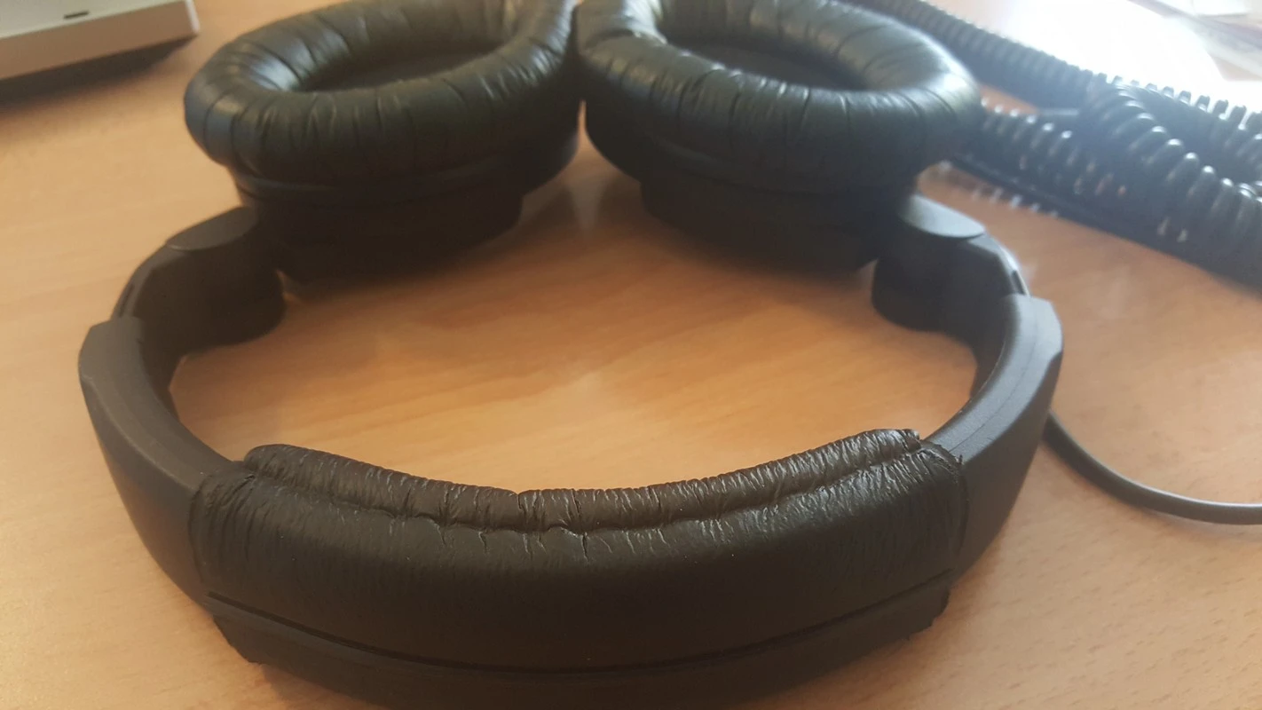

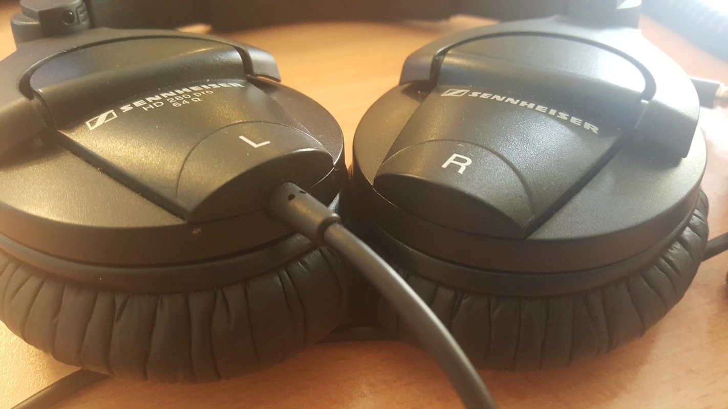

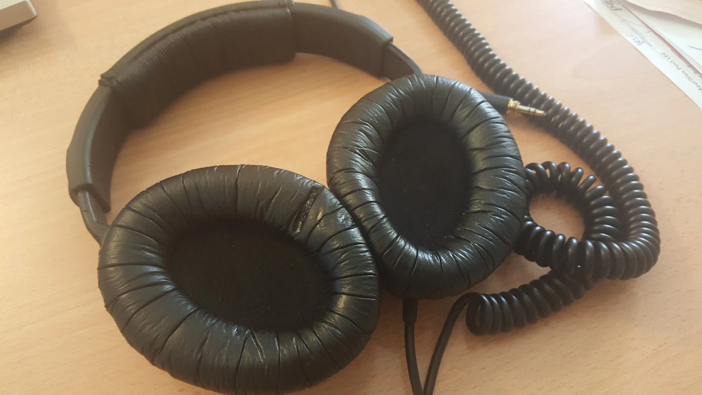

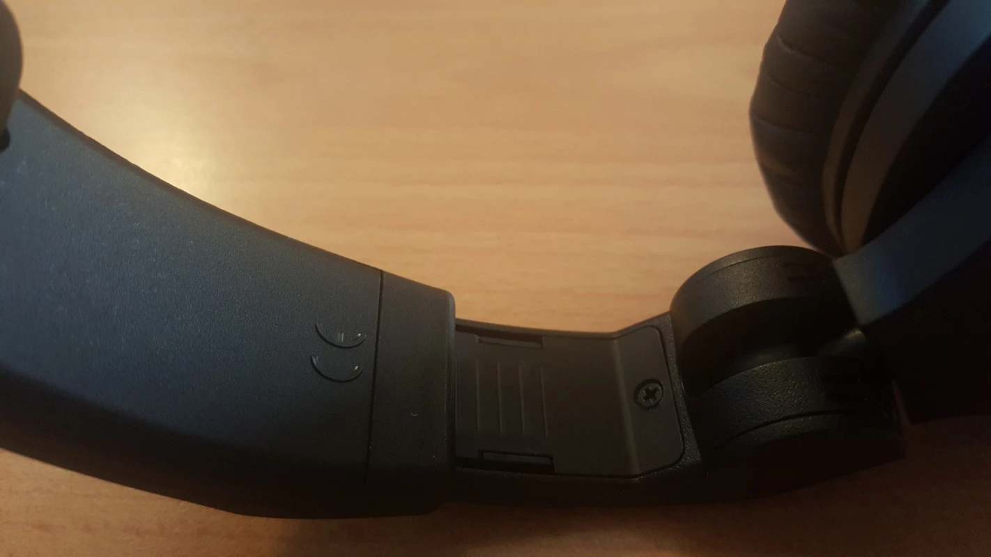

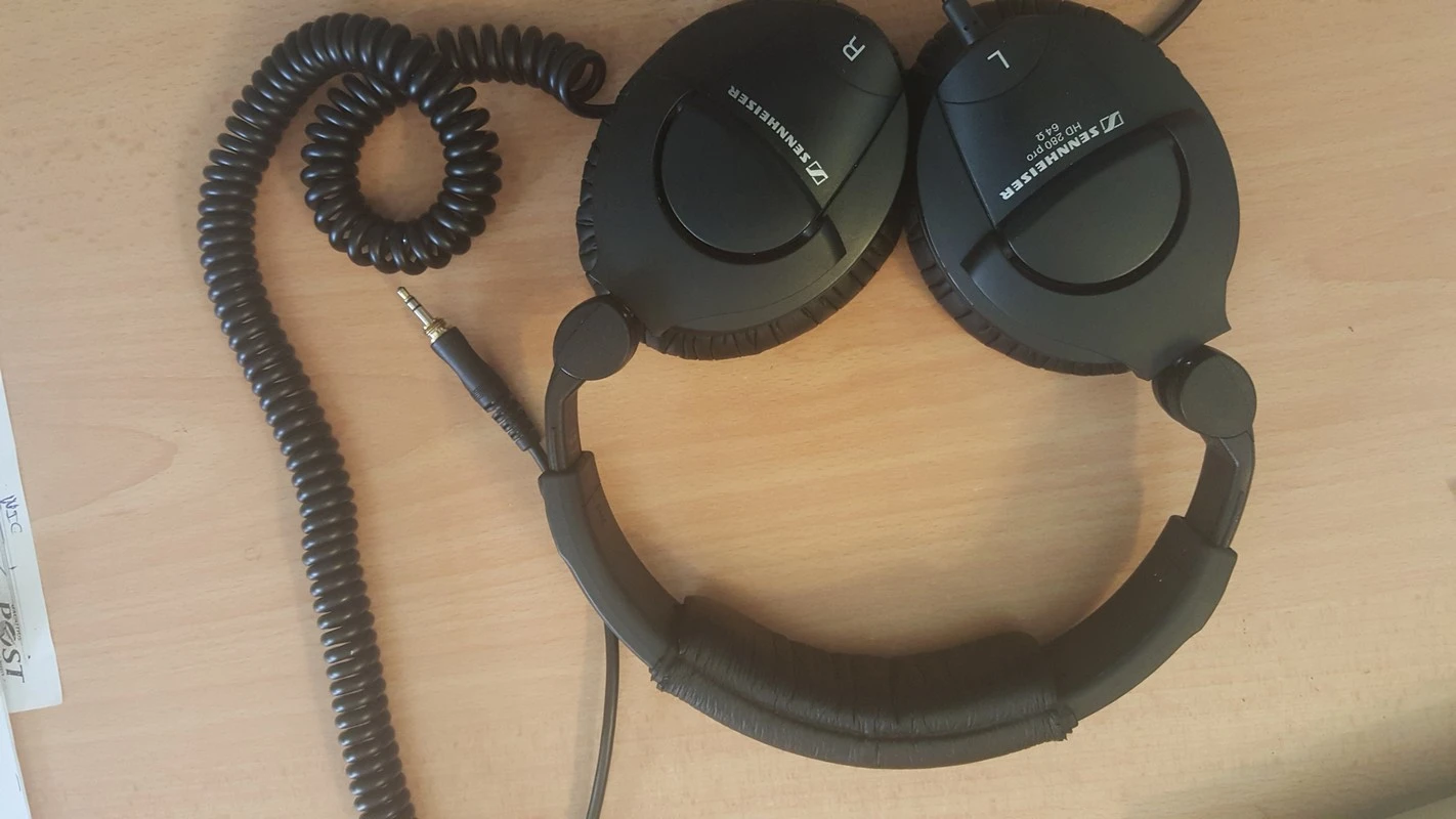

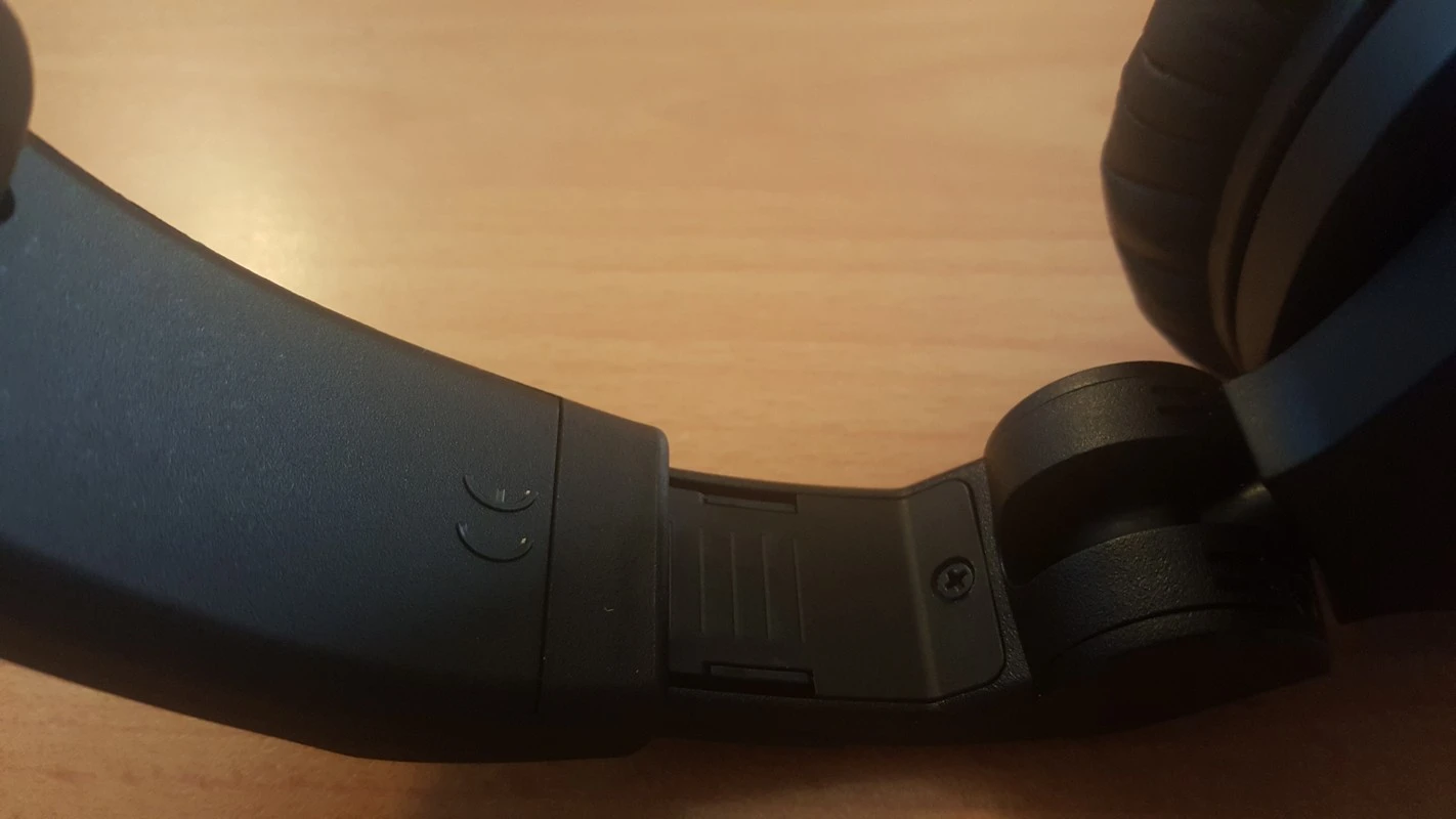

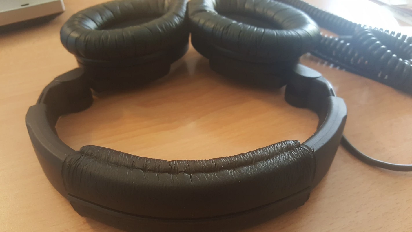

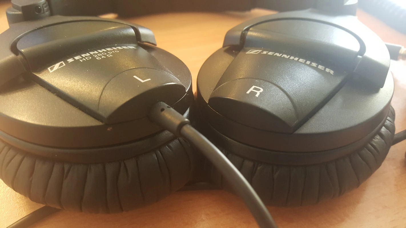

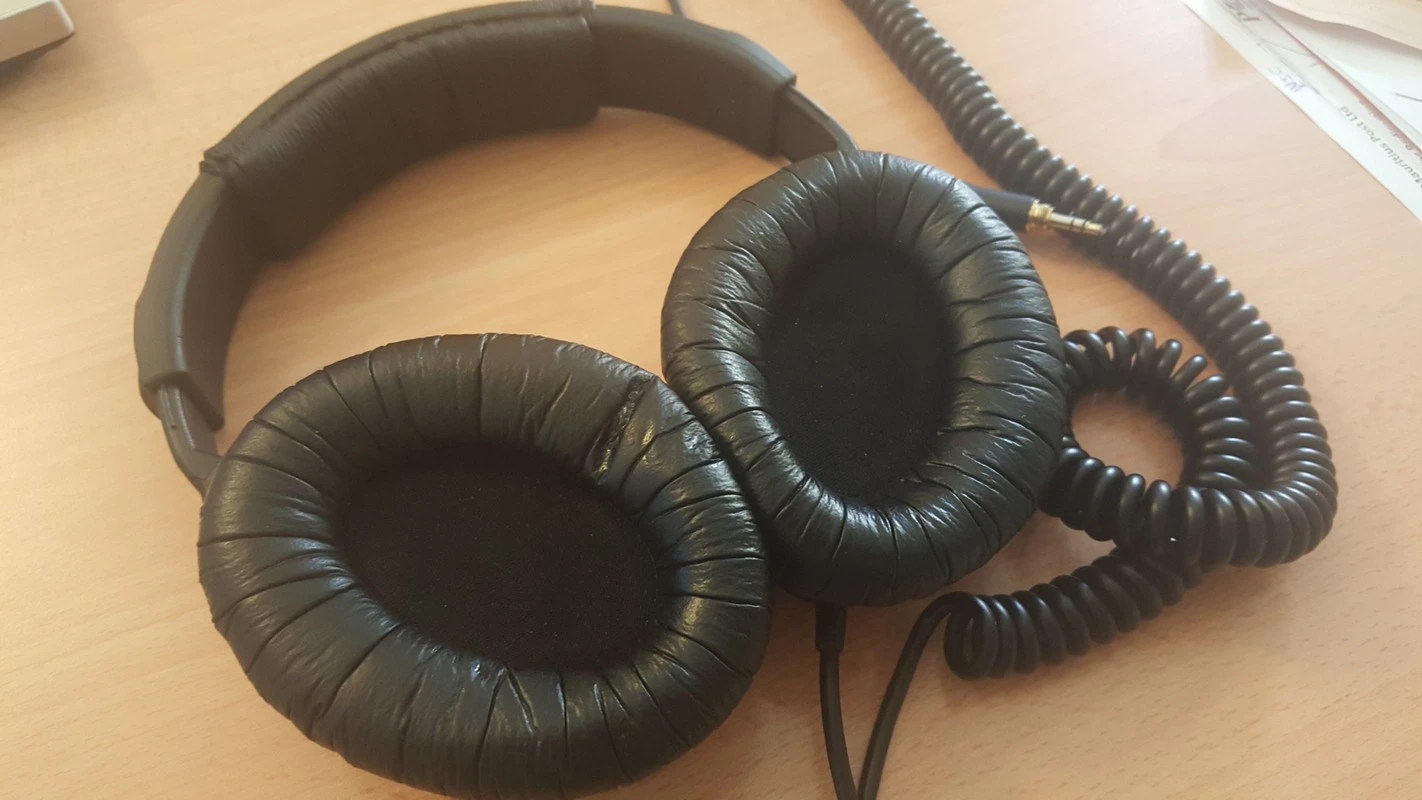

Hi & thanks to all,
[MENTION=19723]CoolCat[/MENTION] (theres fake HD280s? wtf,,,whats next? fake DAW's and Fake Shure 57s?)
I have seen other fake models like this one :
YouTube
though not the HD 280 Pro.
Also I was considering the Sony MDR-7506, plenty fake on the market like this one : 2017 MDR-7506 Professional Closed-Ear Back Large Dynamic Studio Audio Headphones | eBay
I read some articles about the Sony MDR-7506 to test the impedance where fake will show less than 30 ohms.

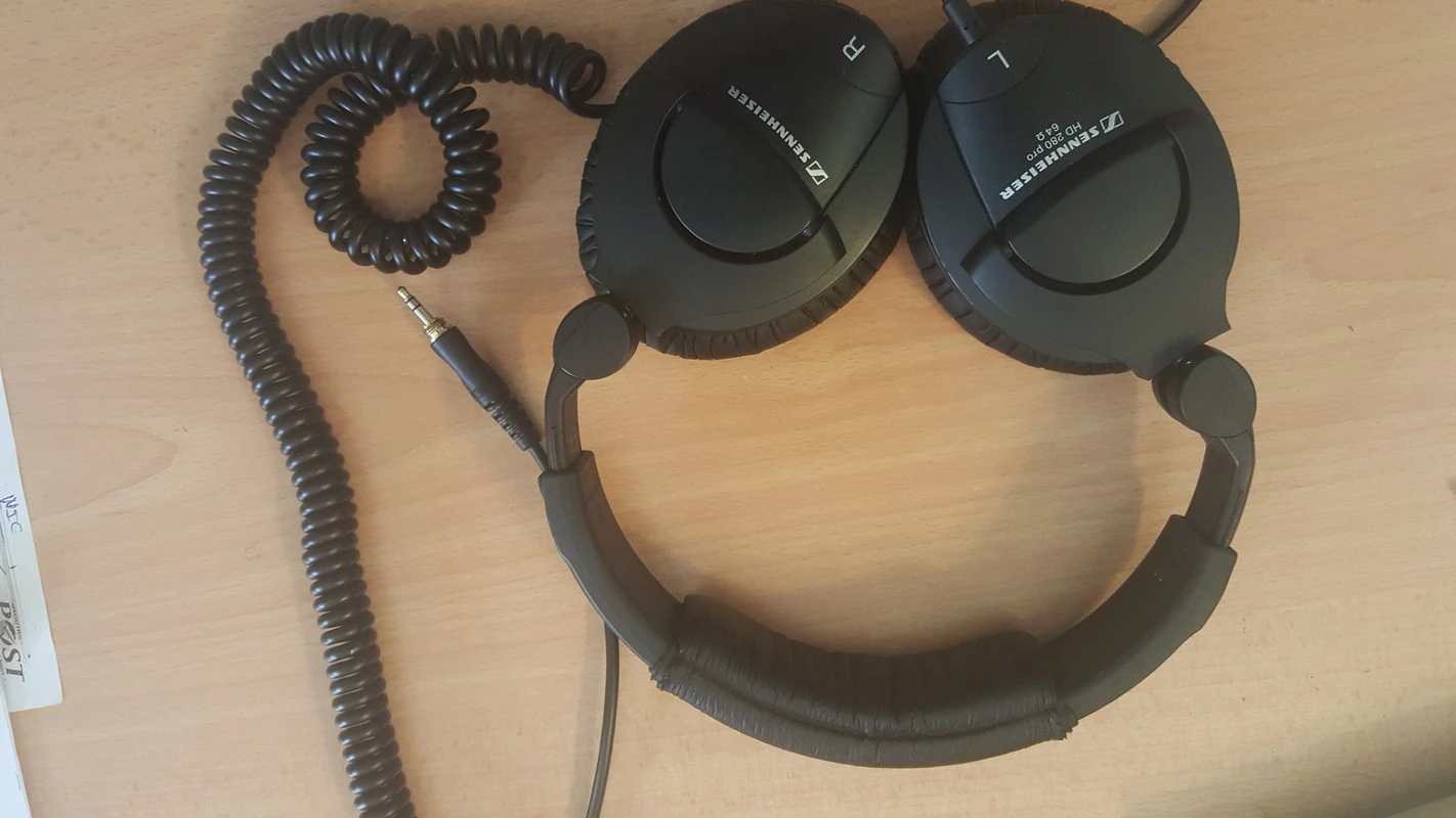

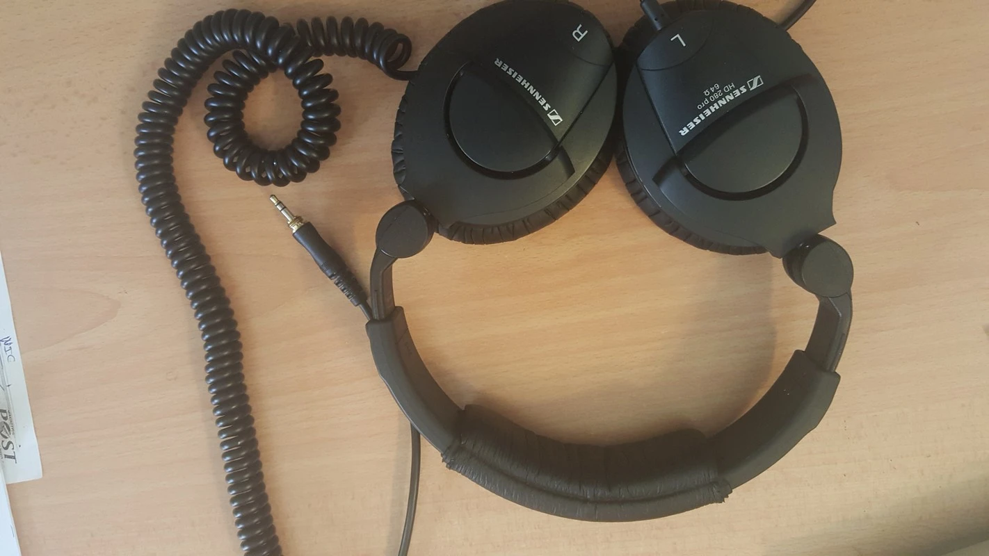

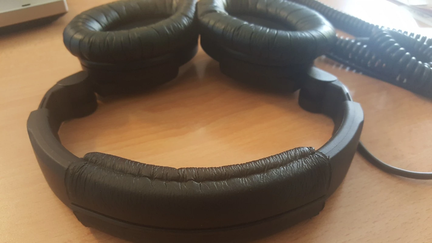

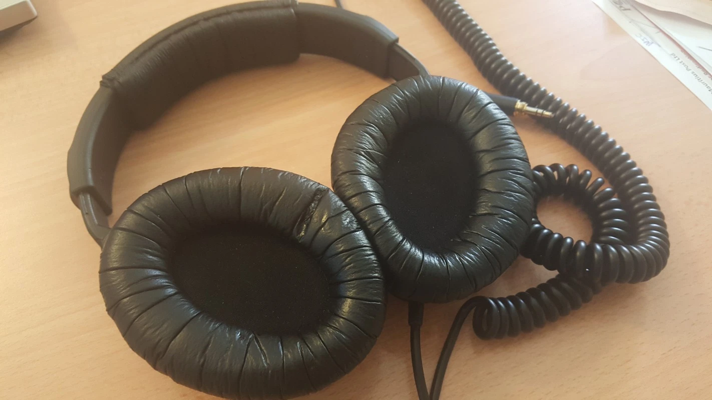

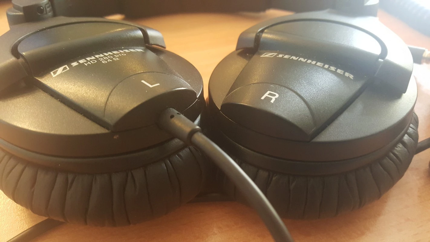

I have annexed a few pictures of my headphone here for people who have a similar pair on hand to compare.
20170831_093545.webp20170831_093530.webp20170831_093558.webp20170831_093614.webp20170831_093632.webp

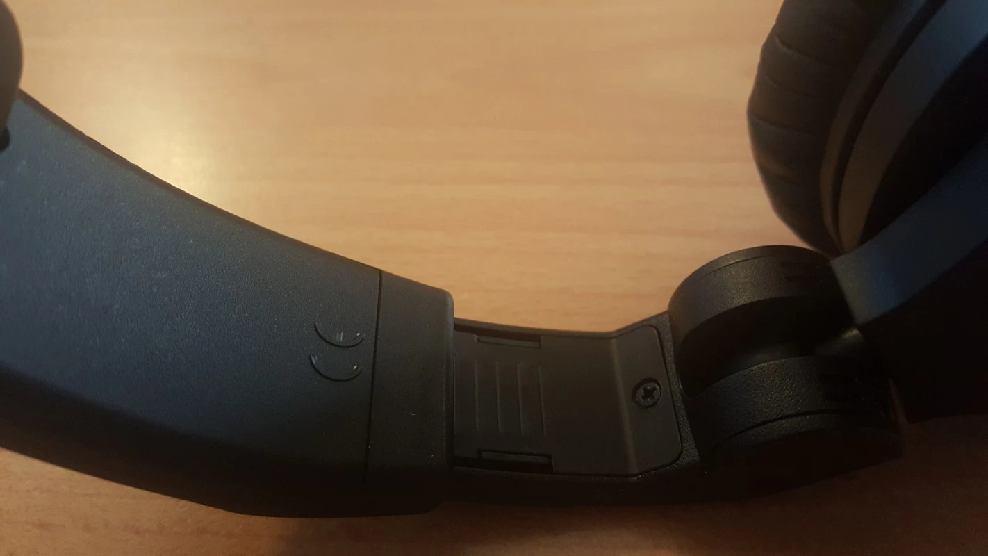

Hi & thanks to all,
YouTube
View attachment 100302View attachment 100301View attachment 100303View attachment 100304View attachment 100305
Yes, checking the DC resistance would seem to me to be a very good way to identify a fake. I would expect the fakers to use some cheap, 'generic' transducer since the average punter would never know or check.
N.B it would be a good idea to buy a 1% test resistor as close to the R of the phones under test. Two 33Rs would be handy and could be used to 'calibrate' the meter which could then be a ten quid 'Halfords' cheapy!
