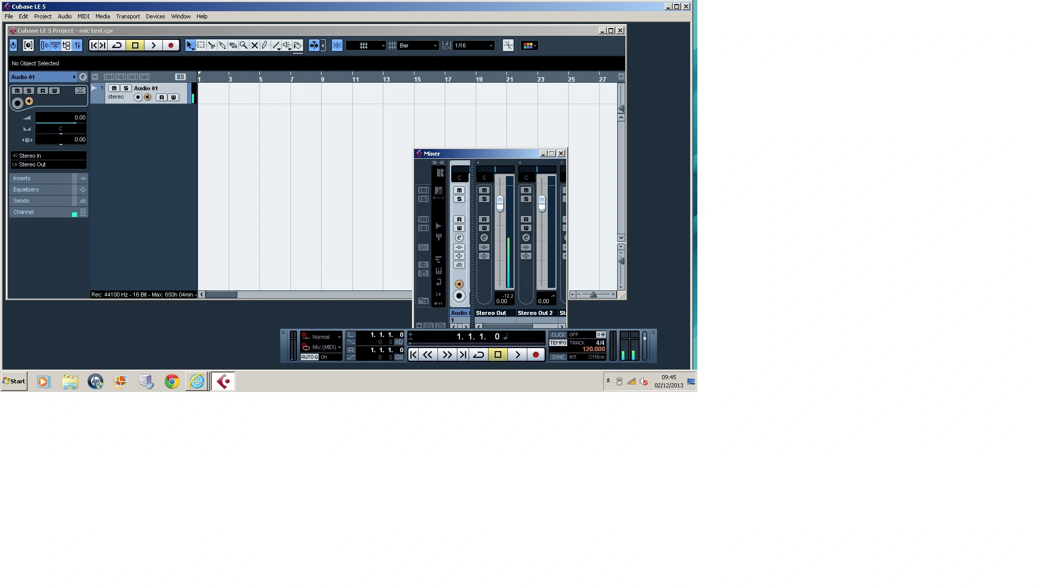

If you are trying to get the signal to show in the mixer (Cubase does not have a separate meter AFAIK) then you need to turn on the wee speaker symbol in the mixer panel.
If you have your connections and routing right you should in any case get the tiny, pretty bloody useless meter blipping in the Transport bar. See my attachment.
You might have determined that I don't like Cubase much! I don't and rarely use it, this LE5 issue came with my NI KA6 and the two perform well together I suspect because of N'Is bloody fantastic drivers!
