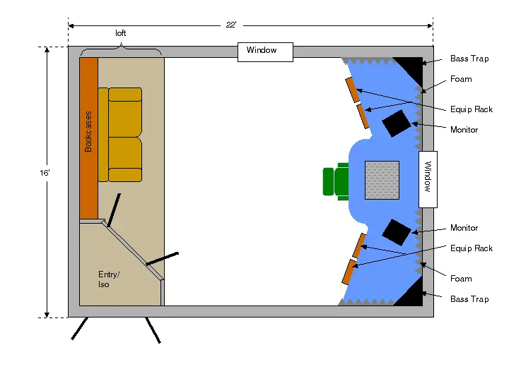

My builder is just completing my stand-alone studio. It is 16'X23' with a cathedral ceiling going from 10' to 14' at peak. It is constructed out of sand-filled cinderblock and has stucco on inside and outside, so it looks cool. I have double pane, fixed frame windows put on two sides (to connect with abandoned family), a small entry way to serve as an airlock with double doors, and a small vocal booth. It has a loft over the entry way end to house a futon and other spousal doghouse ammenities. I've attached a gif of it.
My builder did it (including electricity and dedicated HVAC) for only $10K US. Keep in mind that he was building the main house at the same time and was able to leverage costs accordingly. It is going to be way cool, although I have a lot of acoustic treatment ahead of me, it seems.

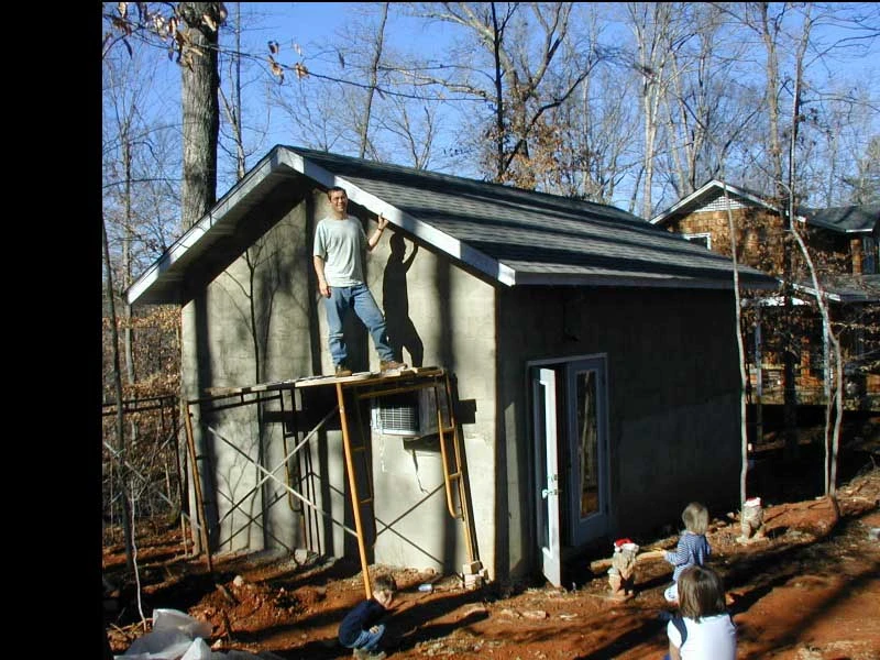

Here's a pic from a couple months ago...

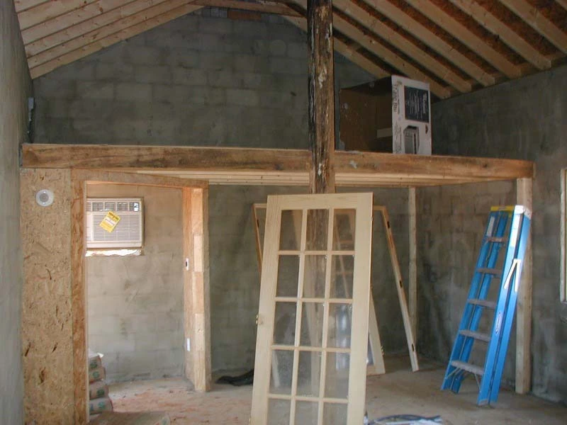

Here's the inside, pre-stucco. You can see the HVAC in the entryway to the left. Also note the loft where I can chill when wifey sends me out of the house for leaving lid up...

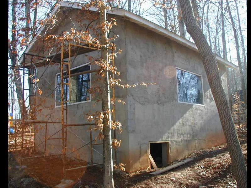

Here it is from the other side. Again you can see the HVAC unit and the ugly goombah modelling it.
There's the main house behind it

That center post in the inside looks like it has water damage. Or is it just old and dirty. You might want to give that a closer look.
Beezoboy
The center post is actually finishing up curing. It is from a beech tree on the land itself. It has dried enough to contain shrinkage, but further curing will give it great cracks and showy knots. It will look really cool and the kharma of using timbers from the land is way out there. It is over-engineered, so it will have no problem bearing the load.
For aesthetics, I will wire brush the final crud off it.
