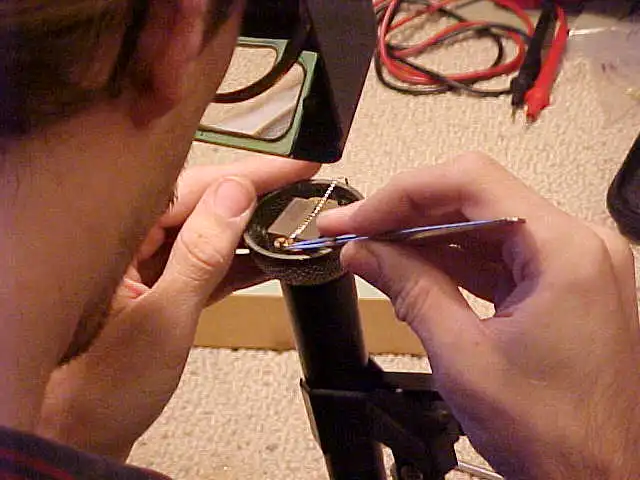

It's VERY close to the sound of the 77DX, although the straight body mic is a lot closer that sound than the tapered body.
I bought the mic on ebay for $65, and you could hear that the ribbon was misaligned (low output, thin sound). I figured I would try to fix it myself, but then I learned of Stephan Sank's work.
I actually drove to his house in Albuqueque on the way to the L.A. AES show and watched him actually make the ribbon, and install it. It sounded very different from Mike River's modded straight body 260 (which I had with me), and we finally traced it down to the cloth behind the windscreen. We replaced that cloth with some original silk cloth used in the RCA 77DX, and it sounded almost identical to Mike's 260.
Here's a picture of Stephan running the ribbon thru the corrugating machine, and installing the ribbon:
