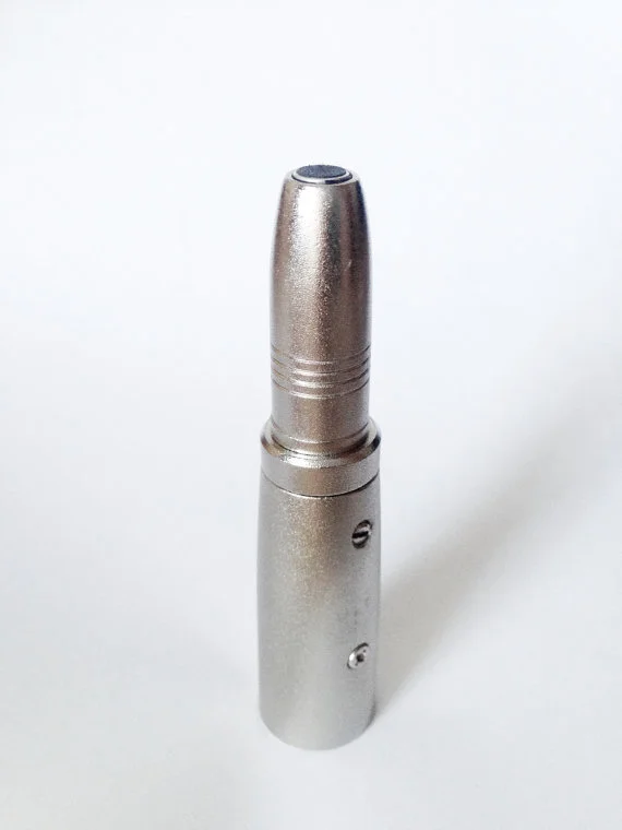

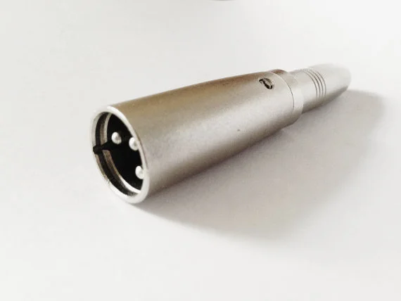

First came out like this, i named it 'Bullet':

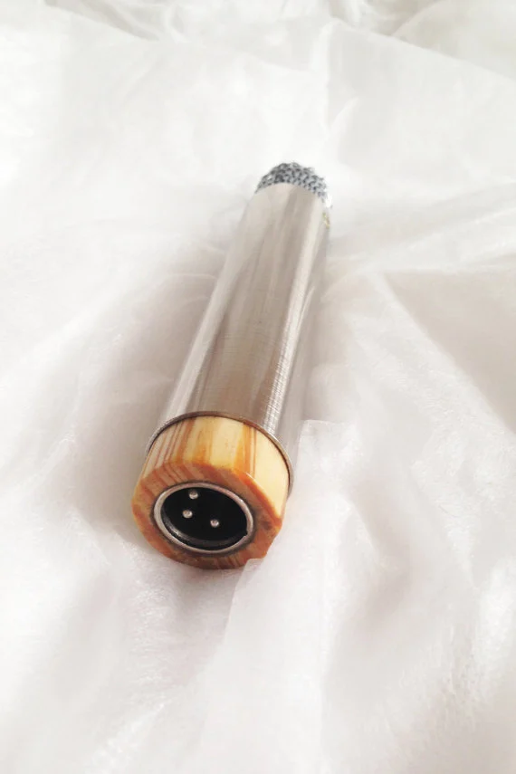

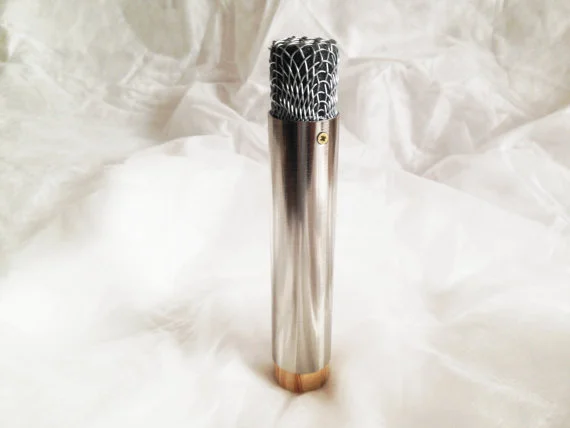

Second 'Saudade'

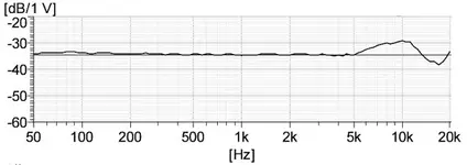

First one uses POM-3535L-3-R PUI Audio 6mm omnidirectional capsule with internal (jFET) impedance converter and is balanced with bipolar output buffer.

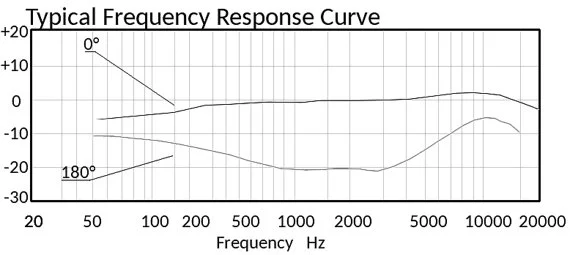

Second one uses TSB-165A 16.5mm cardioid capsule with external (jFET) impedance converter and is balanced with bipolar output buffer too.
