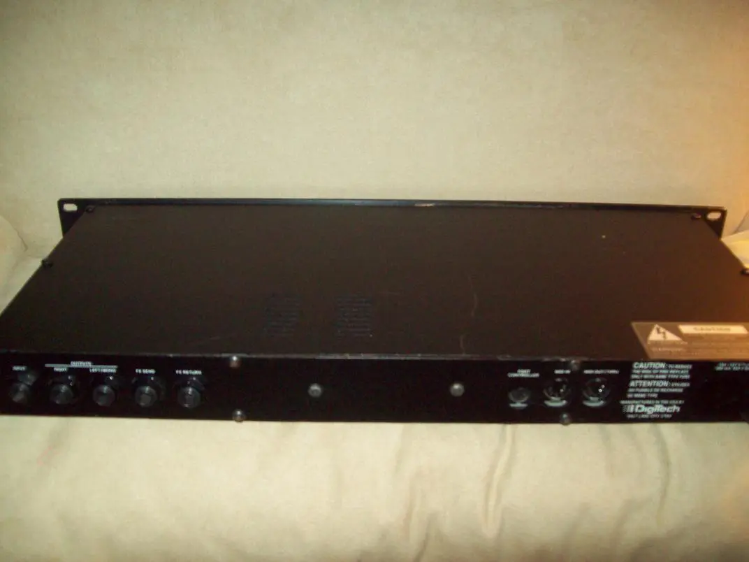

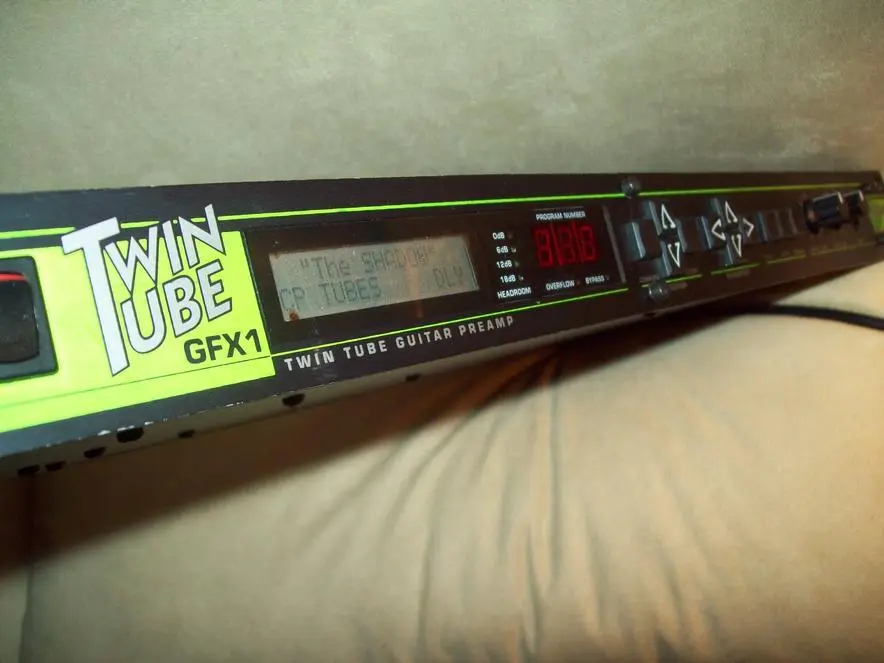

Here is a pic of the guitar preamp I would be using:

Shouldn't be a problem if that's the sound you are looking for. I use an acoustic fender amp sometimes with a SM58 running through the guitar channel and an NT5 condensor for micing the acoustic through the vocal channel and it sounds much better than the other way around.
I'm not sure if I see an XLR in so your going to need an adapter also I don't think that unit will supply phantom power so all you'll be able to use is a dynamic microphone.
:cool:
What are you recording everything else with?
Doesn't your mixer or interface have any preamps on it?
Not saying don't try it out, it could sound really cool, but it's probably gonna sound like vox through a guitar amp which, if it ends up not being the sound you want, you're stuck with it.
You could always record your vocals clean through whatever preamps you have on your mixer or interface, then send them out through the guitar preamp to add a bit of that color to them.

Okay, Ill come right out and say it. Your results will be crap unless you are going for some special effect. Even then it probably doesn't have the right connections, impedance or gain to do anything like what you seem to hope it will do. It is about the wrongest tool for the job imaginable.

That's what I wanted to hear!
Appreciate everyone's comments,..especially yours.
I do have a Tascam m-2600 mixer w/ power supply,
but, the preamps installed seem to be weak.
I was intending on running the singers vocals through my Roland sre-555
chorus echo (which I mainly run my synths through)..
but, it seems I would definitely need a vocal preamp in front of this.
So,..That's why I was asking if there was a way around it with the GFX1
without getting a shitty sounding track. Guess I'll have to have the singer rent one for a couple hours. We are recording "live".
