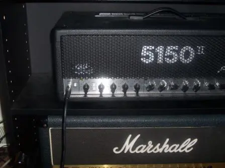

Hey guys. I had some spare time this weekend and I decided to throw together these examples of some guitar mic'ing methods since I see alot of questions on here about that. I don't mean to imply that I know everything by doing this, just trying to give some ideas to the ones that may want it. This will also serve as a way to hear a sample of a couple of widely used guitar microphones.
The signal chain:
Jackson Soloist with Seymour Duncan JB bridge pickup.
Peavey 5150 II, Rhythm channel.
Marshall 2x12 cab loaded with Celestion G12T-75's.
Mic Pre: M-Audio DMP-3. Soundcard: Delta 66
Here's the amp setting used for every example....everything is on 5
Mic set-up pictures and sound clips to follow......

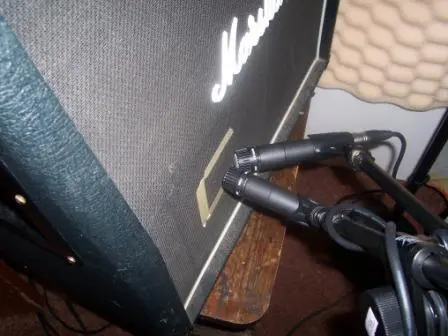

Silly question but, do you normaly make any phase corrections when using 2 57's in the on and off axis setup? And when you say Double tracked on each side, are you saying that each mic is armed for recording 2 tracks each and then panned left and right?
Well, I just place the mic with headphones on to try and find the best spot. By the way, these examples are not optimized in any way. They are tracked as shown and that's it. No EQ or processing at all. They could obviously sound alot better as finished products. I just kept everything raw and basic for simplicity's sake.
There are two performances on each side. Four total.

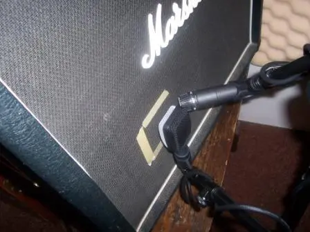

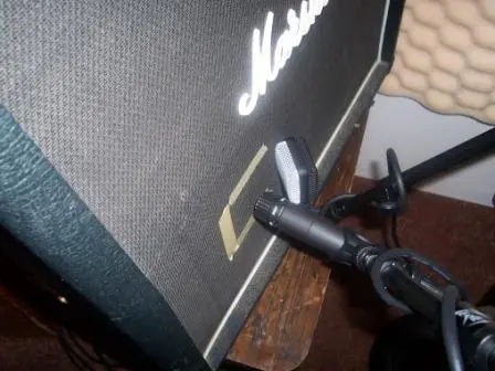

Im really diggin the 609 with the -5db of 57. I just got a 609 for Christmas and I cant wait to put it up beside one of my 57's. I remember when Sonixx did a similar test between a 57 and a 609 several months ago and that got my mouth watering for one.

When I said -5 db I meant that I mixed it at 5 db below the other mic. When I recorded I set the gain to record every mic at the same level.
At -0 I meant that I left both mics at the same level.
