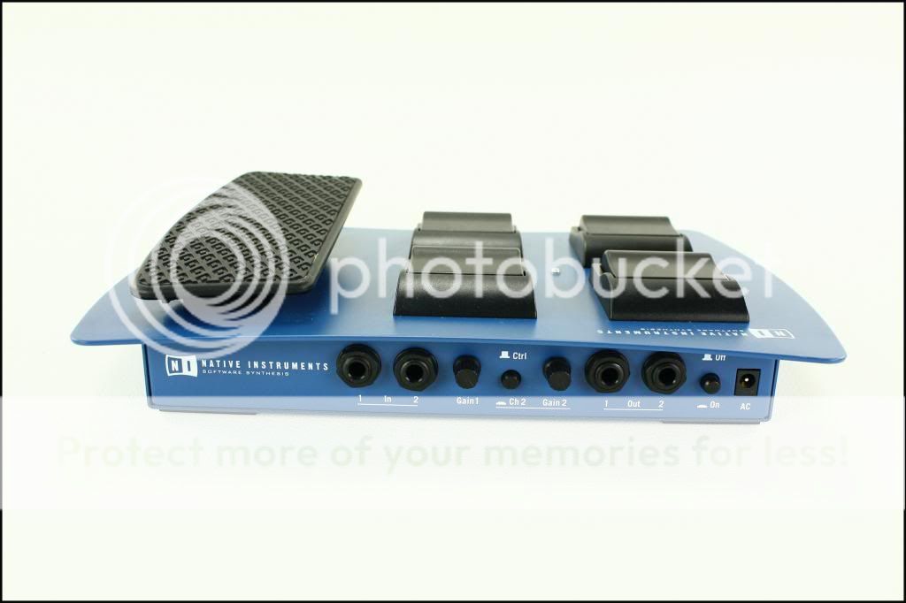

how do I hook up the midi controller?
this is what the back looks like:
I did some research and rea;ize the guitar rig controller you have is and old audio style, not midi (it sends the control signal in an audio format like the sound of a modem). I am not familar with this type of unit, but I did find this entry on the NI FAQ site. Hope this helps:
Setting up the RIG KONTROL 1 with the M-Box
Setup of Rig Kontrol 1 with mbox (Note! It is different to any setup with the Rig Kontrol 2)
Because of the mbox's monitoring nature and the sensitivity of the inputs the setup might be harder in relation to other cards. Do everything from GUITAR RIG standalone to eliminate any other issues.
1. The mbox defaults to mic input which has an impedance that is too low for the software. You have to switch both inputs to LINE in order to use this correctly.
2. Input Monitoring must be off. That means turn the knob to playback.
3. Connect the Foot controller Ouputs to the mbox. Connect Foot Controller Output 2 to mbox Source 2 and Output 1 to mbox source 1. Plug the Guitar into Rig Kontrol Input 1. With this setup you should get the Guitar input fed to mbox source 1 (the top knob on the mbox)
4. In GUITAR RIG you can use the auto mode to find the control signal. Therefore you have to press ON. With the above setup the Guitar signal is on the L(eft). Therefore, this should be selected. If this is confusing you can just turn this ON and do it the long way (explained in step 5). Also open the foot control control panel so you can see everything more clearly.
5. The control signal is source 2. However, it might happen, that the software input settings have changed. Find the Guitar signal. Go to the input module and check the channel. It is either left or right. Select one at first to see if you hear the Guitar or the control signal. If it is the control signal, then the other one must be the Guitar. For this setup, both should never be active.
6. You have to adjust each input gain signal on the mbox to feed an appropriate signal into GUITAR RIG. Be very careful as turning the Control Signal gain very high will freeze the function, a level too low will cause it to not be recognized. With Source 2 set to line the knob can be safely set to the middle.
7. If you encounter problems, make sure that in the Input module Rig Kontrol has not switched to AUTO again.
