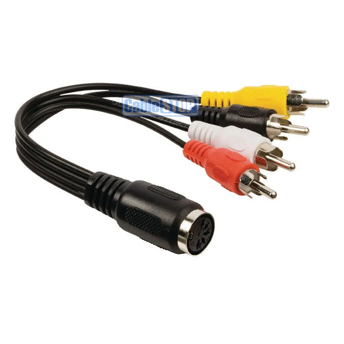

5 pin Din to 4 x RCA connectors is very common, you could get one of these and a mic to rca adaptor and try each RCA until you get the right one that works LOL.
