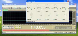

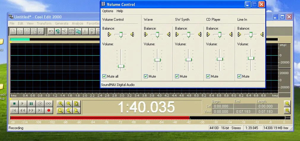

Below is a screenshot of everything muted in the control panel, and Cool Edit 2000 recording a jittery 42ish dB signal of nothing.... What gives????? :( :( :(

I don't think so. Did you look at the screenshot in the first post? Everything is muted, which I thought would cut any "windows mixer" noise out.... but then I'm no Windows expert.....
