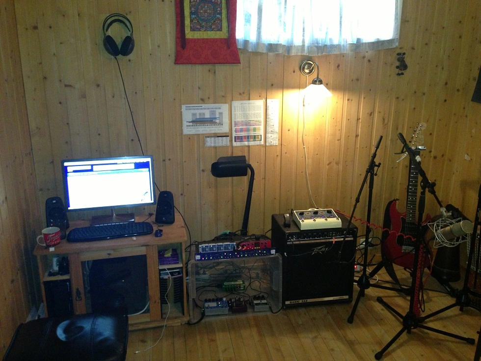

So I finally got to my senses and ordered a pair of nearfield monitors and I decided to rearrange my modest setup in order to place them in the center along the shortest wall in the room. Here is the setup thus far:

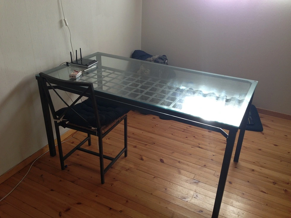

Now, I realised I have this glass table in the livingroom I never use as I'm living here by myself:
Will this have negative acoustic properties?

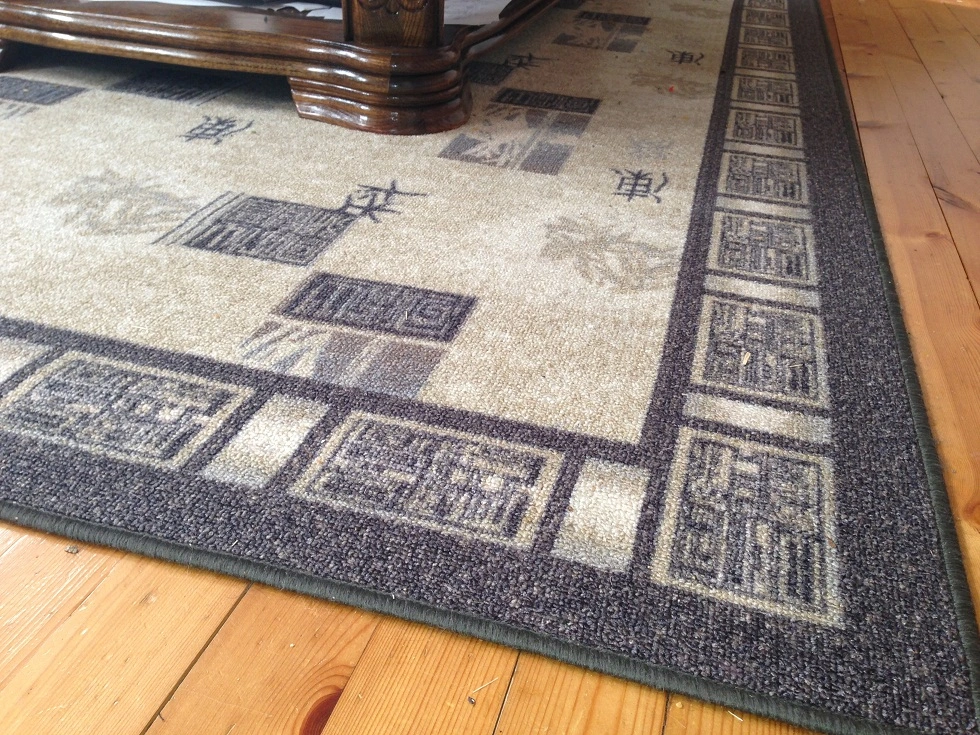

Also I have this rug in my livingroom, will it do any good?

I'm not sure that a rug will make much difference. Just gauge that yourself. If the room is really really bright like a tiled bathroom, I suppose it would do no harm.

Unfortunately the walls aren't as open as they look, since the one to the right is concrete (I live in a basement apartment) but I suppose the wood on top of it helps a bit? I'm not exactly sure what you mean by gauging the rug I guess since english is not my first language, but I suppose you mean to try it out to see if it makes a difference?

And about the rug, yeah, I just meant try and and see what you think. :)
By open walls I just mean walls with space to put panels on.
Ah, I figured you meant open in terms of acoustic properties. I will try the rug, I guess it looks nice in the living room but I rarely find myself in that space anyway :D Besides, who needs nice?
Your plan should be a step forward definitely. Acoustic symmetry is important!
With all that wood though, you'll still have a lot of flutter echo in the higher range (and bass problems down lower as all rooms do). The rug might help with some flutter echo, but acoustic treatment will give you vast improvements in the room as well as your new set up.

But again, will the glass table be problematic?
I will gauge (hey I learned a new word) the rug tomorrow or the day after and post new pictures if there is any interest in that.
If the glass table doesn't rattle, it should be fine for your use. As GIK pointed out, you'll have bigger worries with the wood walls.
You might try to find something to rest the mointors on to help separate them from the table. Dense packing foam, maybe.
get a thick blanket or piece of carpet or something to set on the table .... even a thick table cloth to calm down the direct reflection off the glass.

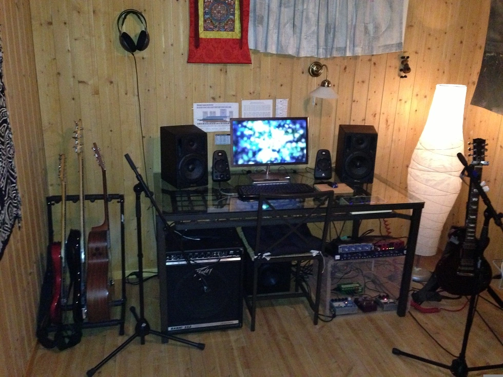

So the monitors have arrived in all their glory! After a hard days work I rearranged everything, and connected the monitors and I was so excited.
Here it is, doesn't look too bad!
