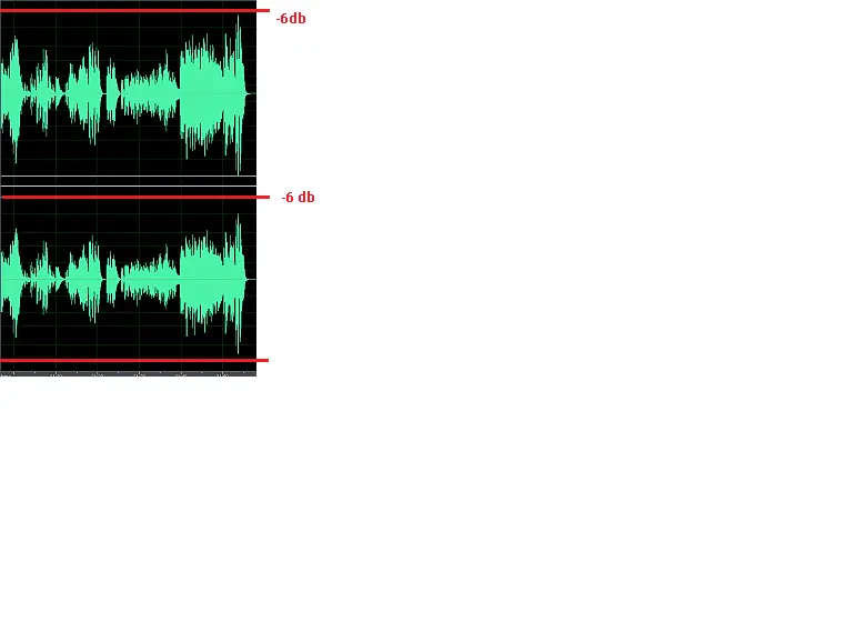

I've been wondering for the last couple of months why my last song on radio didn't so that clear and powerful as in the studio.
The I found out that quite a few people said that when you send/email or drop your song of for a radio station, that the overall RMS must not be over the -6db range...thus, don't compress or limit your song, but keep the song as is.
I've attached a file where the overall range is say within this -6db limit. What should be the main focus to get this sort of song radio ready, since the song contains quite a few dips below -18db...?
How do we keep the songs overall clear and punchy without going over the -6db limit and not using any compressor or limiters to get the soft parts up? waveform.webp

Second, your pictures seem to indicate that you are mistaking peak volume for RMS volume as the RMS for those waveforms looks more like a normal -20dBFS RMS, or thereabouts. RMS indicates a type of *average* volume, not the highest peak volume of your loudest transients.
Third, the advice that your RMS should be less that -6dBFS is good advice, as nothing other than pink noise that has an RMS that freakin' high is going to sound good, especially on the radio. Your RMS should be a LOT less than -6dBFS. Especially for a song like yours that has so many rests in it (which will automatically numerically drag the average level down.)

I'm not a "meter and waveform" guy -- But those waveforms don't look anywhere near averaging -6dBRMS. They might be *PEAKING* at -6dBFS -- and -6dB(FS)RMS is far too loud anyway.
Get it to the level where it sounds right but still has reasonable dynamics. A crest of around 15dB is almost universally a "nice place" and you aren't going to get more "radio friendly" than that either.

Hi SouthSIDE Glen. Your are correct, my mistake with the RMS. I' should have been -6dBfs, not RMS.
I think the problem with our little song was that our dynamic range in our MIXING stage was not looked at. We didn't apply proper compression or limiting to our tracks, and we ended with a song that's dynamic range was to wide. Getting proper mixing is a very big part in getting the true radio ready song and applying good EQ, Compression and limiting to work with the dynamics will help the song in the long run. So we are now back in the studio with our latest track and man are we learning! :)
