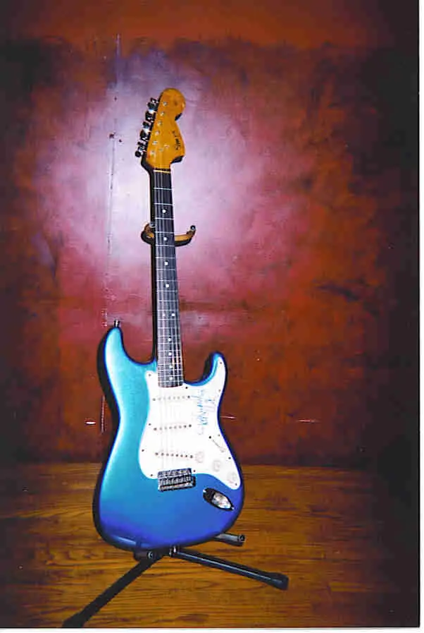

I disagree that "Doing a guitar finish right is a strictly professional job; unless you want to spend several thousand dollars to get setup to do it."
I refinished my '66 strat in lake placid blue nitro laquar, and I would put it up against a professional job any day of the week. It is beautiful, and slick as glass.
Go to this website: www.reranch.com They sell all the paint in aerosol cans, every gauge of sandpaper you need to cut and buff the finish, and the finishing polish to put the final gloss on your guitar.
You get complete instructions to walk you thru the whole refinishing process (from taking off the old paint to buffing out the new finish). the only thing you will need that they don't supply is a drill and a buffing pad.
The paint is top quality and never in my life have I seen aerosol cans spray as even a pattern as theirs. It is amazing.
My cost for a "professional finish":
2 cans of color ($15.95 ea.)
2 cans of clear ($12.95 ea.)
7 sheet pack of sandpaper (different gauges) ($5.95)
1 can of nitrocellulose sand and sealer. S&S acts as a grain filler but also levels the wood before shooting the color coats ($8.95)
One Pint of "Finess It" (enough for about five guitars). $14.95
Total= $87.65
There is no way in hell that a professional will even think about doing a finish like mine for less that $300.00 (that would be cheap). I wouldn't trust my guitar to someone, who claimed to be a pro, if they would do a paint job for under $300.
Reranch carries dies, 2 and 3 color sunburst packages, and when you e-mail them with a question they get right back to you.
I wanted a very high quality finish on my '66 strat....I wanted nitro laquar. It is not the "original" finish, but it is the "correct" finish (with the correct white primer).
It takes a little elbow grease, but it is fun. Like I said, check out the site and look at some of the "do it yourself" finishes posted there.
Its the only way to get a really high quality finish for under $100 bucks IMO.

I have some pics. I will have to find them and load them on my hard drive. I'll do that and post them.
I will say this about finish and sound:
I got that strat in 1976 and it was sunburst (original nitro finish). I was 16 years old, dumb, and natural wood finish strats were all the rage. I sanded the original finish off the guitar (very "16 year old" boneheaded move...I admit it). To my dismay, the alder wood didn't have the right look....the 70's natural wood strats were ash wood.
The guitar sounded fantastic with the original finish. After sanding off the finish, I found a rebel flag pickguard and painted it Confederate grey and put the new pickguard on. I was in the military and had access to all their paint , activator, primer, and spray guns. The paint they were using to paint helicopters was Dupont Emoron. Emoron is a very tough polyurethane paint....the grey I used was emoron. I put coat after coat of that stuff on the guitar and sanded in between coats. Next I put coat after coat of clear on it. I bet that guitar had 20 coats of poly paint on it. It sounded just as good after that paint job as it did with the original thin nitro laquar coat. That was in 1979. The rebel flag pickguard didn't last, I put a black guard on it and it kept the grey poly paint for over 20 years.
Last year, I decided that I wanted another color. I wanted it to be period correct for a 1966 strat (gey poly isn't even close). So, I talked to the luthier that did my fret job (he is the best I have ever seen). I told him I wanted the poly taken off down to the bare wood and painted back 3 color sunburst...using the correct yellow dye ( fullerplast?). Anyway, He said "man, you are talking about a major ordeal, and I can't even really give you an estimate on that job". I wanted it right...but I didn't want to sink $600 in a paint job. Bottom line is this, I found out about the reranch website and I decided to give it a shot (nothing ventured, nothing gained).
The hardest thing in the whole refinishing project was getting the Emoron off. I applied coat after coat after coat of the heaviest duty paint stripper known to man. It took me 2 weeks of working every day to get it off. (you have to be careful if you sand it...you could change the contours of the guitar...I wasn't going to sand a '66 and take that chance). I researched all the color options for 1966 strats and decided to go with lake placid blue over white primer. I put all the original plastic and pickguard on back on it (until Ted Nugent signed the pickguard....then I put a blue pickguard and black plastic on it...didn't want to rub off the signature and cartoon Ted put on it).
I was offered $3500 bucks for the guitar (I paid $150 for it in 1976). I would never had that kind of offer with the grey poly paint job. But, after haveing that strat for 28 years...Im not ever going to sell it anyways...so, who cares.
It dosen't sound any better with the new thin nitro paint job than it did with the thick ass poly paint job. The thickness and type of finish just dosn't make that much difference IMO
One more thing as a "by the way" comment. When I stripped off the poly paint, the original yellow dye, original factory pickup cavity markings, and original factory neck pocket markings were still in place...who would've ever dreamed? Those Fender factory black markers and yellow dye was some tough stuff!
these are not the best pics in the world...but you get the idea
the pic files were too big lasttime,,,see if this works
(had to do these in "low quality" to get them to upload)
