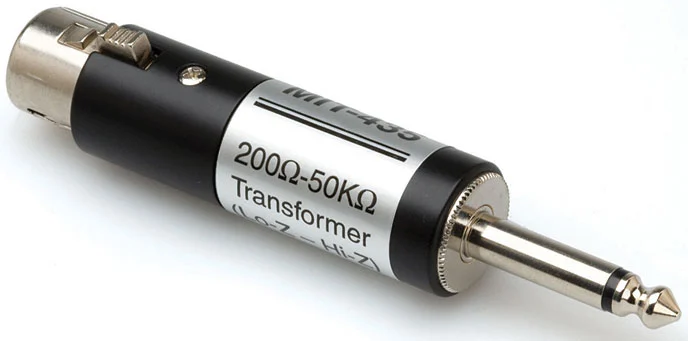

Can't see what the problem is here, unless there is a bad connection. How have you converted the XLR mic lead to unbalanced jack plug?
Also the mic will be low impedance (LowZ) and the mic input on a TEAC deck will be High impedance, but I have used LowZ mics many years ago on TEAC decks with no problem, it could be that the LowZ mic is causing a miss read of the metering somehow? If you have one of these around try it on the input.

Yes I was using an adapter on the Shure. I just repeated the experiment with a super-cheap Radio Shack mic equipped with a 1/4" jack instead of xlr with the same result.

I suspect as someone suggested earlier with the transformer post that it is indeed an impedance mismatch with the mic. Read up on the decks specs and you should find the info you need. Good luck

Thanks everyone. Seems to be and issue of raw mic signal/impedance in this particular deck. All is well, thanks again!
