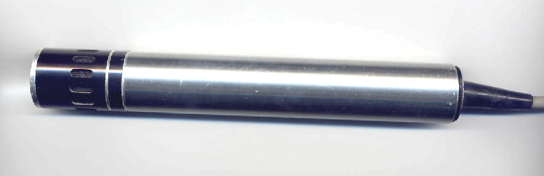

I have recently been given a pair of Teac MC-201 condensers.
Do you have any knowledge of these mics?
They are still in their original cases with mounts, etc but I think the electrolytic capacitors may need replacing.
ChrisO :cool:
Probably a rebadged Primo or Sony. Both these companies make a lot of different condenser mics for sale by other manufacturers.
Got a picture?
Harvey,
Thanks for your reply. The details are on the base of the mic around the cable outlet. It says "TEAC MC-201 Electret Condenser Mic. 600 ohm Made in Japan"
I'm just curious as to whether they would be useable in our studio for acoustics, o/heads, etc.
Scanned pic attached.
Many thanks........ChrisO :cool:

I don't think it's a Sony - probably it's a Primo. How useful is a little harder to answer. Try it on a few things.
