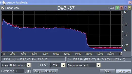

Hi All,
I looked into several commercial CDs to compare with my mix and found that those songs have hi frequencies above 14K or 16KHz reduced dramatically down below -100dB while between 2K and 14KHz, it's moving at -36dB to -72dB. As seen in the attached images captured from Adobe Audition Frequency Analysis Tool.

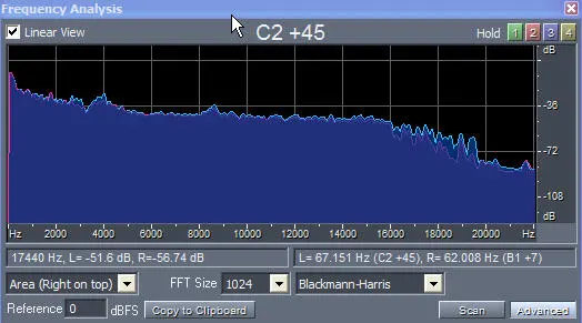

Could anyone describe why those hi frequencies get cut a lot and what kind of gear possibly used for that (brickwall limiter, multiband comp?). Or is it because of .wma/mp3 format trim it down? My mix (PCM wave format) always have those frequencies moving around -70 to -100dB (please see the 2nd image).
I'm kinda worried that I might do something wrong while mastering and cause the frequency to be such a difference to those commercial stuff....
Lighten me up, please....
Bill

What kind of music are u using for ur test? What kind are you making? The highs probably weren't cut, just nothing up there.
The first spectrum looks like an mp3 or some other codec was used on a wav file. What is it we're looking at exactly ?
Oh - I see, you said it's an mp3. That's some of the lossy mp3 style codec working - there's also some type of brickwall right around 14-16KHz or so too. depending on the bitrate you select I suppose. Don't take my word for what mp3 does though I haven't studied it - just know what it's spectral fingerprint looks like. A high shelf EQ with a steep slope would do that too.

Yeah...it's compress format
Hey Seifer...It's from CD that I bought...what wrong with checking out my own stuff...
Thanks for every replies...because of a compress format, huh, that cuts high freq out...wma format does it as well as mp3 and others I think...

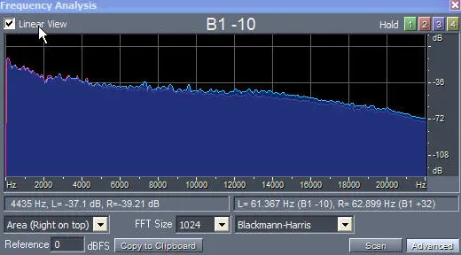

Now, here..., I think, is a good frequency curve from a decent mix...as a reference to anyone who intestested to see...mine is pretty close...
Thanks everybody...
