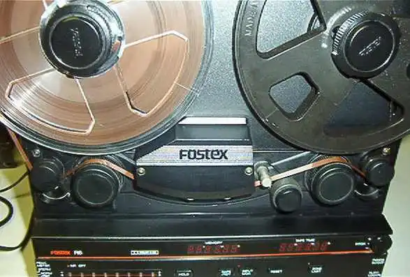

Just incase here is a pic of my R8 and the proper way to thread it. I just love the Fostex R8, Its so portable for a analog 8 track. ;)
Good luck with your machine
