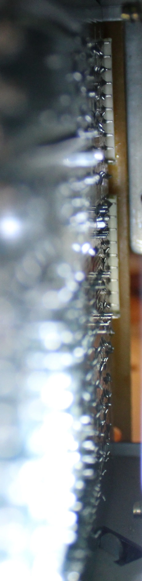

I have pulled the case off and had a look at the cards. I have no clue how to remove them Scared to pull on them too hard but the will not budge with a little force. I have included pics of the cards and how they attatch to the boards...
box.com/s/gj2b2owtufipm6h1d27l
It looks like they are hard wired to the main board.

Oh, yes. I have a nasty feeling they are soldered in on the R8, in which case you can't. Not without actually desoldering them from the motherboard which I would not recommend.
