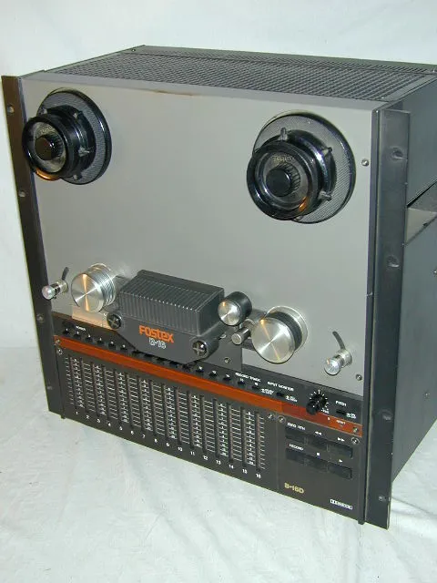

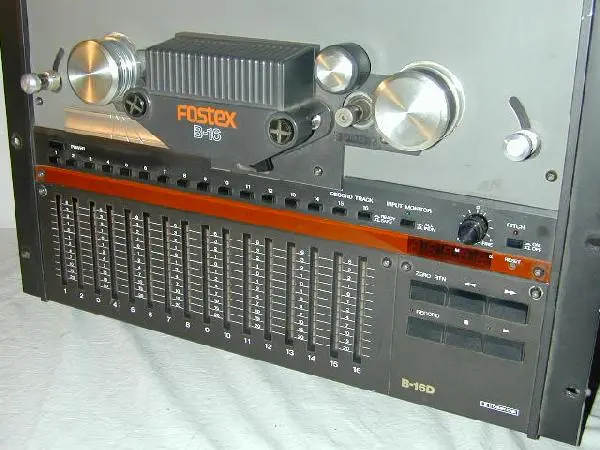

And we got pics... here is one from my overloaded hard drive. It's even a 16D... how 'bout that. :)

I have a feeling that the B16-D runs at 30ips instead of 15. I'm not sure, but if so, it's really going to eat through tape.
It's 15 ips w/Dolby C as far as I know, unless someone modified it.
Here is a site with on-line calibration sections of the manual I almost forgot about.
http://synthetizer-sche.chez-alice.fr/listtape.html
But I have seen others mention 30 ips, yet have seen the D listed for sale with a 15 ips spec.
30 ips could be kinda cool for tracking though... about 16 minutes per tape.
Anyone know for sure?
From what I can tell it looks like 30 ips was a factory option, so it could be 15 or 30. It involved a fairly simple board mod at the factory, but also a complete recalibration. Thus it can't be switched from one to the other by the end user. :)
PLEASSSSSSSSSEEEEEEEE make SURE it's 15 ips. Unless you like dishing out double the cash for tape.
I had one just like that, and it was 30 ips. I couldn't modify it down to 15 without doing some serious board work. It's not as easy as pulling a card or removing a jumper.
the 30 ips to 15 ips modification requires a new whatever-the-crap changes the speed card, new track cards, and a new counter card. Not very reasonable. Watch out.
