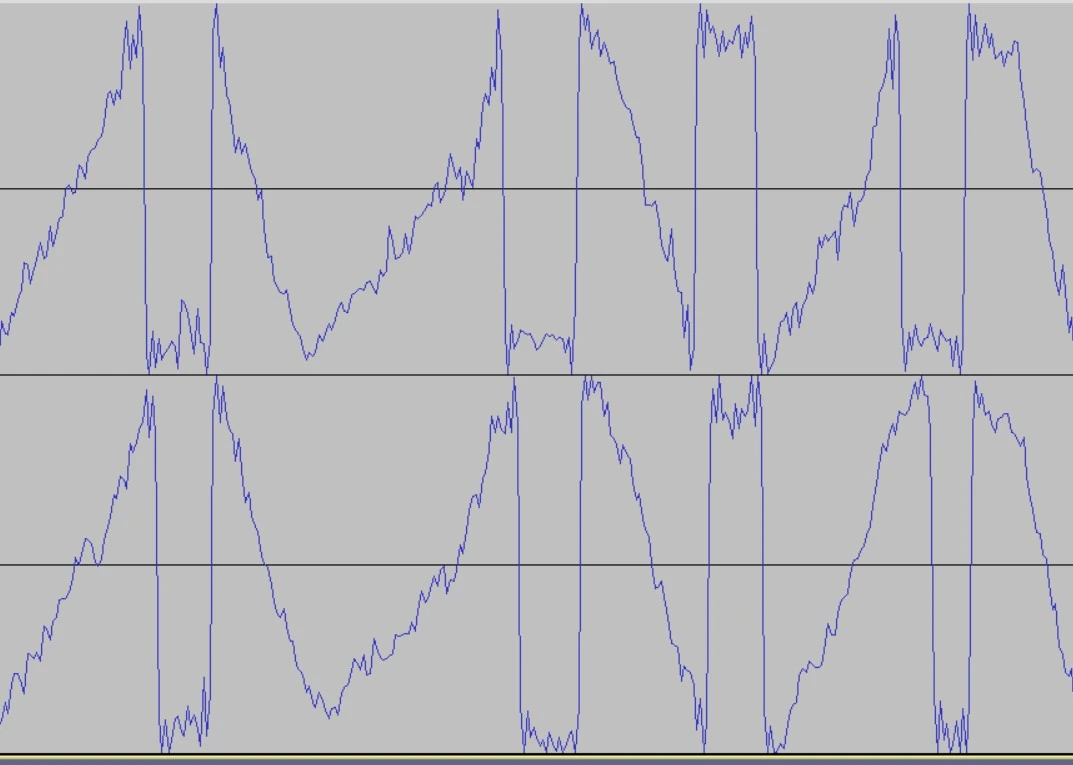

Actually increasing the number of bits does exactly allow for higher headroom. Since you start at 0 (no sound at all), the theoretical limit is 98dB for 16 bits. 146dB for 24 bits and 194 dB for 32 bit if you use fixed point. Using 32bit floating point can do 1,528 dB of range. Of course you'll never record 1,528 dB unless you are sampling something like nuclear explosions or exploding stars!
I think the reason has much more to do with avoiding the case of someone setting a level, say boosting a signal by 50dB, and then a sound that is 100dB hits the mic, and you end up with 150dB or 54dB more than a 16 bit system can handle. This is from a cell phone recording that I did at a concert. It completely overloaded a DAC, which confuses it and it gives bogus numbers.
Using a 32 FP system, this is avoided. Any distortion you get will be from the analog section, not the digital section. Plus I've read that there are advantages when applying effects from a mathematical standpoint.
