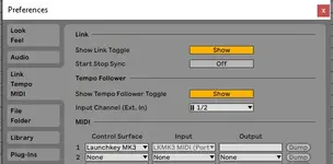

I enabled the follow button, but how can I set the audio track as the tempo leader?
I found this: Open Live's Preferences under Link/Tempo/MIDI > Tempo Follower and set the appropriate audio inputs for the incoming audio source.
You will see the green volume indicator next to the input. Make sure to set Show Tempo Follower Toggle to Show.
This is from Ableton's website. Let me know if this gets you where you want.

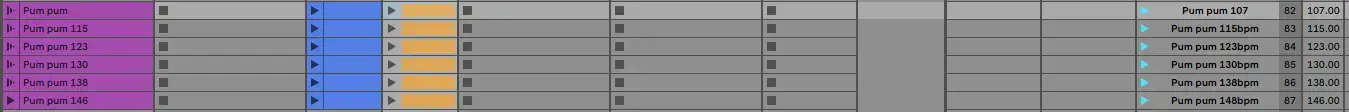

Here are some screenshots of my current setup:
I don't see any option to set the audio track as lead track though
I was testing on mine, looks like the naming BPM is for older versions, but you have edited 1671136214377.webp. That should change your tempo for all of your clips, including MIDI in the row. Maybe the problem is that the follow only works with audio. You probably need to "fix" the audio to match your tempo for that row.
I will continue to look, but it doesn't look like follow controls MIDI. If you find something different, please post here, I would be interested to know as well.
