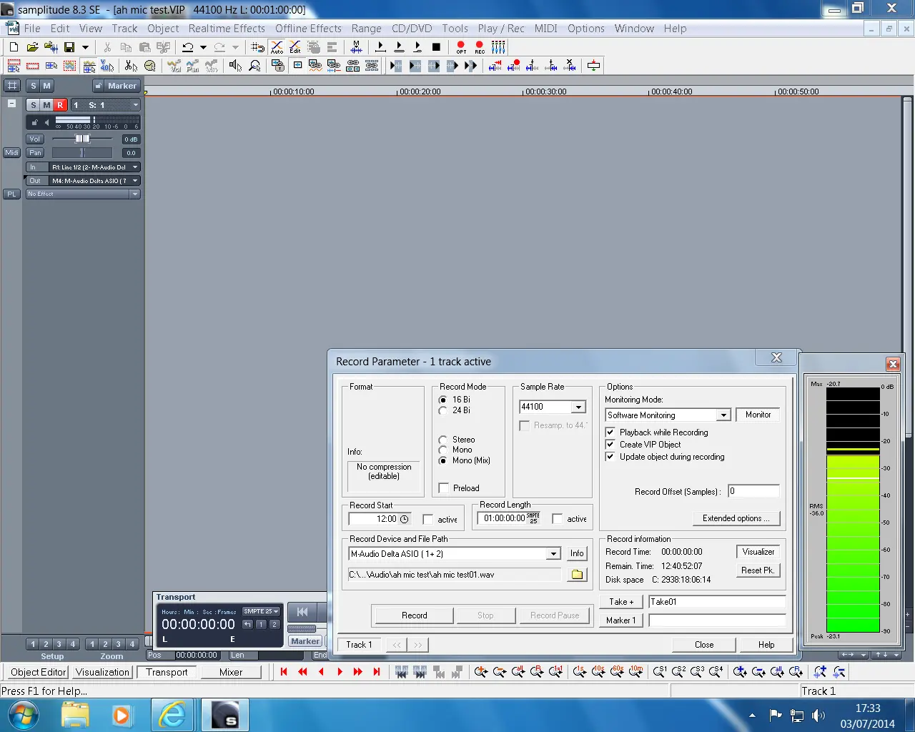

Now I know you can pull all sorts of I/O stunts in Samplitude that other DAWs don't seem to letcha! Not, I hasten to add, with ASIO drivers.
OP could try downloading Focusrites MixControl? This only works with my 8i6 as a dongle and I never really investigated its properties. The 2i2 might let you use it?
Now, almost daily I run BBC radio3 and record it in Sam SE8 (pretty sure I have done it with Reaper? Will try it) Now Sam records the radio because I select "MON MIX" as the input. I could just as well select "Delta 1/2" in the 2496 card and record a mic from my mixer?
Yup just done it. R3 is playing nicely in the background and the input is to ch1 of the Delta card. I record just voice on the mic (if of course I turn down the monitors) .
Another useful property of Samplitude is a very simple Mono record selector that means as can be seen on the meter, the mic is in double mono.
Now, can this be done with an external USB interface? I will investigate ASAP.
