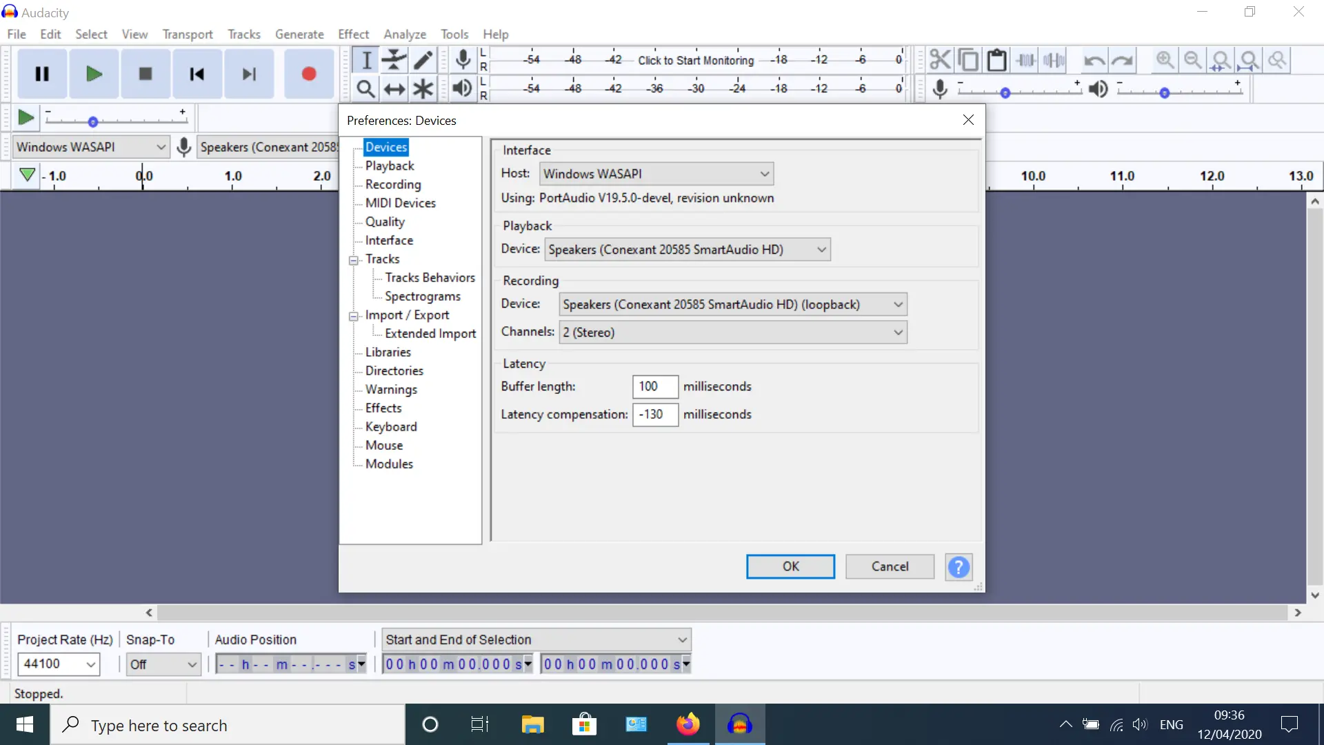

Further information has emerged! A guy on soundonsound forum said "Why don't you just use Audacity?" I had not considered it because this Lenovo has no audio input but I did try it and WAHHEY!! It works a treat. The attachment shows the setup from 'Preferences' and if the box 'Software playthrough of input' is ticked in 'Record' untick it otherwise the system goes into an ape''t howlround.
You can also set for mono or stereo and 24 or 16 bits. I have it set for the latter, no point in better fro Radio 3 over the net and certainly not for YT!
