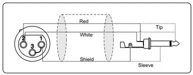

You're absolutely right!All three all very important factors that are usually not taken seriously.I'm recording mainly synths and maybe acoustic guitar and percussion in an untreated room with SM57s and 58s so my preamp quality will probably "get lost" if i don't take into consideration the room reverb.Anyways i got in touch with a guy selling a used Tascam and i saw that the xlr inputs are not combo so i refused to buy it because i wanted to further research if regular 1.4" TS cables from unbalanced sources (synthesizers) need some kind of converter to xlr or worse if i need to buy/make 8 new TS to XLR from a microphone cable.I know i probably should've taken it because even the cost of 8 new cables will be significantly less from buying a new 18i8/18i20 but somehow i became anxious about it and left.:facepalm:
:facepalm: indeed. While the first 8 inputs are straight XLR (Mic) the next two are selectable between DI or line in and have an input level control. Then there are four more line in's in the back less level control but switchable from -10 to +4 operating level.

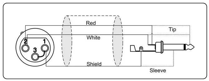

I am right about the first 8 though?It would require a 3 conductor mic cable TS > XLR in order to connect line level devices right?!
Something like this:
